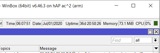

Here is a real example:
As you can see, the uptime is over 36 days, being a client’s router.
If you use stable versions of RouteOS you will not have stability problems and you will not need to restart the router. At least not in the home setup.
