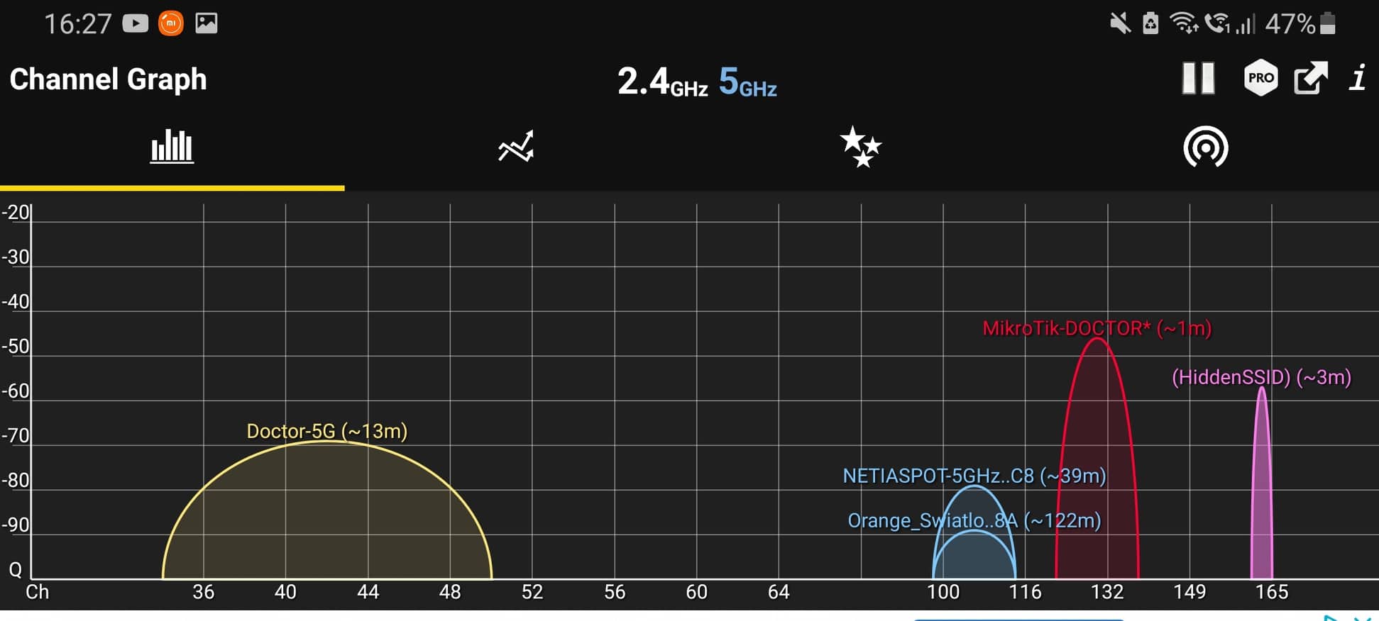

I have attached the config and a screenshot of how 5ghz networks looks in my area.

This looks like an issue on the AX200 end. Check if you have the latest drivers for it as people in different forums have complained about the same issue with AX200
