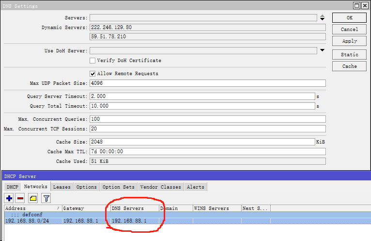

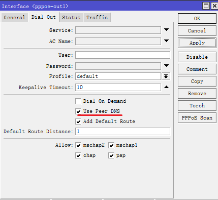

I bought a hap ac2 and configured pppoe client on ether1 port. However, it is very slow to access the network and sometimes even lose the connection.
Using ip dns cache print, I found that the dns cache is very slow, and it takes about 10 seconds to receive a response.
This problem occurs when using peer dns, but when i set public dns works normally.
So I tried to manually set isp dns on my computer, and it worked normally.It does not seem to be a problem with isp dns.
After reconfiguration and netinstall my router, this problem is still unresolved.
I tried to use other routers, and there is no such problem.
Here is my configuration

I got two dns addresses from pppoe-out1, 222.246.129.80 and 59.51.78.210.Can’t ping, but can be used normally.
I tried to use the dig command on my computer, and can get results.
I try to set detect-interface-list=none,it didn’t work。
I tried to use the following combination, this is my result.
(1) No DNS setting in dhcp-server network
Internet works fine.
(2) dhcp-server network DNS set to gateway of bridge network 10.10.10.251
Internet error,can’t open web page.
(3) dhcp-server network DNS set to gateway of ppoe-1 connection

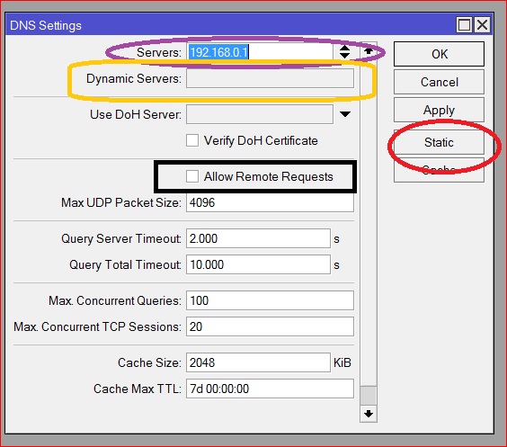

Okay so thats a lot of info and not a clear flow chart picture in the mind.
But you havent delineated, WHAT ACTUALLY TELLS the router that we want to use the router for DNS ???
Please correct all my wrong headed thinking!
  1. To bypass router DNS usage then put in public DNS servers under DHCP-SERVER -NETWORK
    such as 1.1.1.1 or 9.9.9.9
    Assuming that the users on this subnet will not utilize the router (input chain) and will go straight from LAN to WAN for DNS queries.
    Assume this is the only way to bypass router DNS.
  2. Using any PEER =yes settings, simply tells the router YES please, use the DNS available through the ISP as part of your input supply of DNS.
  3. Allow remote requests, simply tells the router YES please, use other servers besides the DNS available through the ISP
  4. Dynamic Servers, list of Servers the router will cycle through if not in the router cache
    order would be
    Dynamic server1
    Dynamic server2
    ISP peer (if peer allowed)
  5. For DNS server in DHCP SERVER NETWORK, one can put any subnet gateway that is on the router and IS this tells the router you want to use the router for DNS??
  6. YOu can select NO dns in dhcp-server-network, What would be the result of doing that?
  7. One can elect not to put any DNS server settings in dhcp-server-network, what would be the result of that??
  8. what happens if you put the LANIP of a raspberry pi, for DNS purposes, what then is the relationship to the input chain.
  9. As in 8, when is it mandatory to ensure users have access to port 53 on the input chain??
  10. What is the purpose of the default static IP DNS serting, how does that fit in the hierarchy?

  1. The router will basically automatically provide DNS servers with DHCP leases unless, the admin puts in public DNS servers or something locally like rasperrby pi also behind the router on the DHCP Server Network settings for DNS.
  2. Setting Allow remote Servers is not any clearer other than it has nothing to do with clients requests?
    What other queries other than the routers ones would exist? I have set this for enabled and it sounds more and more like it was for nothing.
    OR, do you mean we have to have this enabled for ANY CASE in (1) where we specify to bypass the router doing the DNS queries (such as want to use 1.1.1.1 or 9.9.9.9 or rPi etc.).
  3. The static selection I was talking about is circled in purple (where the default sticks the default gateway I believe). Okay I see where peer DNS would show under dynamic.
    Also I see the static location where one would add 1.1.1.1 or 9.9.9.9 if you wanted them available for the router to use.
(4) The question I have is if peer DNS is turned off not used and NO external DNS addresses provided to the router. HOW, WHERE does the router do DNS… ???
Assuming each subnet has its gateway set at DNS server.
(5) Same question in 4 and but now the admin has left DNS server entries blank in the DHCP server network settings?
  1. DHCP server will try as hell to provide some DNS server address in DHCP lease unless router admin knows better :wink:
  2. Where’s setting “Allow remote Servers”? If you’re talking about “Allow remote Requests” … then it’s got everything about client requests. If this is set, then router will listen for UDP connections on port 53 (standard DNS service port). If it is not set, then router won’t listen for those connections and clients won’t be able to use this service.

Many new users have that static setting left over… what do you use besides winbox LOL,
Yes allow remote requests… okay good I have it on for a reason :wink:
peer dns is dns service from ISP, so if that was enabled, then the router would have a source for dns services… if nothing else was available.
I thought it was obvious … ssh client.
Thank you very much.
I plan to use Routeros as the dns server of the local area network, because its dns cache function is really usefull.(For me)
I want to use the dns server provided by the ISP instead of the public dns(like 114.114.114.114,223.5.5.5…),Because the ISP dns server responds faster.
The ‘peer dns’ I mentioned is actually the DNS server provided by my ISP.
Sorry to trouble you, because English is not my native language,I use Google Translate to communicate.
There may be some errors in my description, let me post some picture to illustrate.By the way, after resetting the router many times, I gave up changing my router ip, and now my router ip address is 192.168.88.1.The address NAT converts is 192.168.0.100.
Combination (1)
By checking the wireless connection of the mobile phone, I got these dns addresses:192.168.88.1; 222.246.129.80; 59.51.78.210
In this combination, I can use the Internet normally without worrying about not being able to open the webpage.
Combination (2)
I set allow remote requests= no.Others are the same as combination 1.
I got these dns addresses:222.246.129.80; 59.51.78.210
Combination (3)
I got one dns addresses:192.168.88.1
In this combination, my mobile phone can hardly access the Internet, and other devices are the same.
Combination (4)
I set ‘allow remote requests’ = no.Others are the same as combination 3.
These test results bother me, why the dns provided by the ISP cant work on the router but can be used normally under the LAN client.
