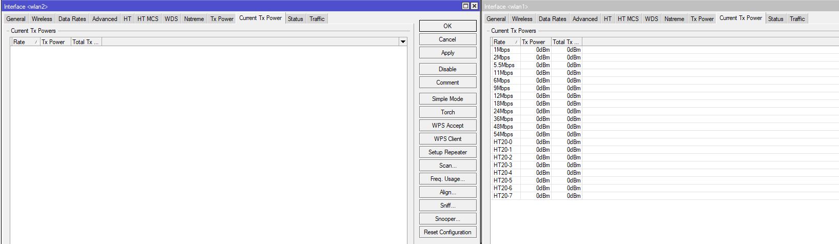

This is where the plot thickens, the Hap AC2’s dont show power

Indeed :frowning: In console it shows all zeroes for current Tx power … One of beauties of wireless on ARM …
mkx check out TX power rates with manual setting. It I believe shows what the default settings are!
It’s not just ARM, that is true for all 5Ghz radios in 802.11ac devices.
