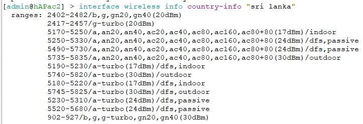

I don’t know if You still have an issue. What I have noticed recenlty with mikrotik wifi is that it may vary tx/rx strenght a LOT on different channels.
I observed this behaviour with 60 GHz links (only 1 channel out of 4 gives super performance, stability, and stable signal power).
I observed this with hap ac2 at 5 GHz. Try out this settings and different channels:
COuntry: sri lanka
Instalation: any
Frequency-mode: manual-tx-power
Band: 5GHz-A/N/AC
Channel width: 20/40/80MHz XXXX
For me frequency 5200 work very well. Now i have signal strenght in registartion table -55, on different channel and settings it was -70. Exactly the same place, laptop, environment.
That looks to me like antennas or analog part of the radio is mismatched to certain frequencies.
  1. with XXXX you have no control over which freq will be used, 20 MHz wide control channel (C) position can be Ceee, eCee, eeCe, eeeC. However with the non-DFS nature of that 5200 frequency , it will be eCee (5180-5200-5220-5240) by Mikrotik, as MT avoids mixing non-DFS and DFS appearantly. Check it in “status” of WLAN interface.
  2. with installation “any” you have the correct setting. Nobody forbids outdoor frequencies to be used indoor, only Mikrotik device does this with “installation=indoor”
  3. 5200 is not your “strongest” signal possible. It’s only max 17 dBm (including antenna gain of 3dBm), even if you set higher manual TX-power under “regulatory domain”
    BUT: interesting country “sri lanka” as that country allows for Frequency-mode=“manual-txpower” (!?) while setting the country frequencies.
    If I use this here (under ETSI regulation of 23dBm) the received signal at the laptop (inSIDDer sniffing) jumps from -61dBm to -55dBm.
    Very tempting with all those non-compliant AP’s around, giving a +10dBm signal strength even when set to the correct country.
    But it is illegal.
