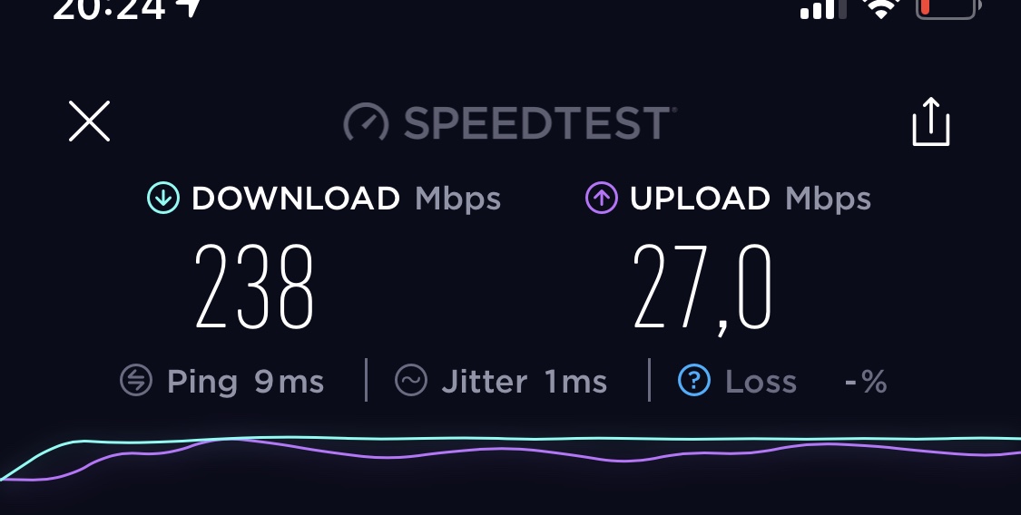

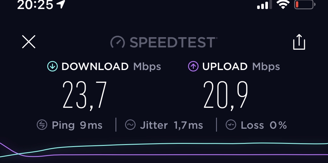

Bought a new hAP ac^2, and having difficulty getting any speed on my wifi.
I have 250 mbit down, but using the MikroTik I only get around 10-20… (2,4 and 5 ghz.)
Using 5 ghz with my old Asus router, I get 238 on my iPhone…
LAN speed is no problem, I max out my connection right away.
I tried all 3 firmware currently available, 6.42.9, 6.43.3 and 6.44beta28 with no measurable difference.
I tried all different channels, only 2.4, only 5 ghz etc.
I´d be happy to supply anyone with whatever logs, info, config etc and all help is much appreciated.
Thank you.
EDIT: If I turn of the security profile, I get full speed.. so must be something related to that feature. Any idea?

Thank you for the help.
After trying different things, this is my setup.
Now I get the speed I expected :slight_smile:
Strange that tkip affect the speed that much…
