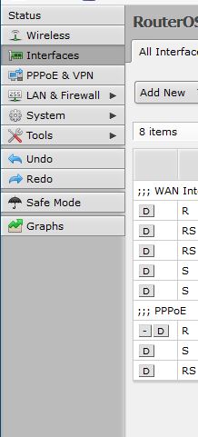

The main reason is they restrict access.. This is all I see in RouterOS
But do You need more than this? I mean, you do seem to have access to firewall, wifi and LAN. If You want something more, by all means buy one. Otherwise, why not use it? It is already there! :smiley:

I suppose I do not really need anything at all in the menu options as it stands, I just do not like the fact that they restrict it for no reason really after all the T P Link was just an “off the shelf” router with nothing altered or restricted, and any cable type router will work OK.. just need to add the PPPoE settings ..
I just like to get the full package, to see what the full potential of the router is, it is not a major issue, just me being fussy lol.. Plus it is still using an old version of RouterOS and I cannot keep it up to date as the “check for updates” button is disabled… :frowning:
