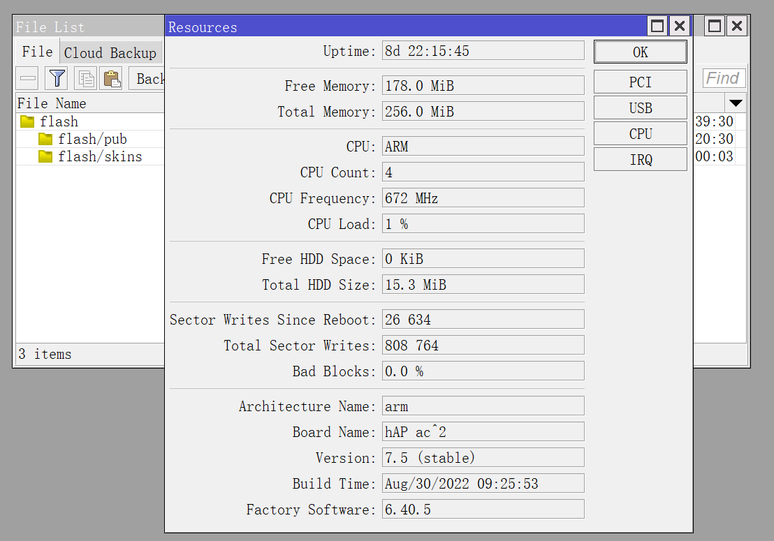

hAP ac2: "Free HDD Space" has become 0 KiB
The problem is that on RouterOS 7, there is a fatal data leakage issue. The symptom is that the available space of your RouterOS will become less and less, to the point where it may reach 0. If you restart RouterOS at this point, your RouterOS will be dead, and you can only solve this problem using Netinstall.
This problem is not as obvious in other RouterOS models, but it has become a serious issue for the hAP ac2, a device with only 16M memory. After installing the completely new 7.7 system, there is only 1-2MB of available space left.

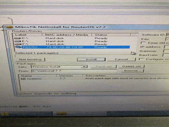

Out of space problem is probably from left overs from old configuration, logs, graphing, possible file system corruption. Export full configuration (not backup), net-install and restore exported configuration should correct the issue.
Differences between free space on identical configured routers can be due to logging, graphing, possible left overs from file system issues or upgrades.
Most of these issues I have seen from routers that have been upgraded from ROS 6 to 7, and have not been net-installed to completely refresh the file system and restore the config export (not from a backup). On routers with small storage I also never keep any extra files on them, always remove any backups/exports for safe storage.
I agree with your statement, so in the past, I also performed netinstall on the problematic devices, but found that the issue still persisted. To be honest, I’m not sure which configuration caused this problem.
The official ticket has identified the problem and confirmed that there is a leak, but there is currently no specific timeline for the fix. They also did not inform me which of my settings caused the leak. It seems that I’m the only one who has experienced this issue.
By “experienced”, I mean on a fresh netinstall of RouterOS 7 on hAP ac2.

I recommend to do a /export show-sensitive in a terminal window, cut and paste that to a file on an external computer, then netinstall the thing to a recent version with no default config, connect via MAC address and paste the saved export file.
Best is to omit non-critical configuration at that time, i.e. only add the basic config you need and see how it behaves, add the rest later.
