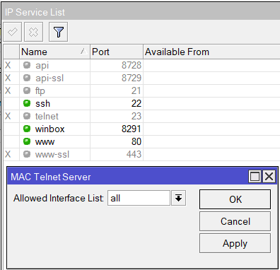

way and disable services, to prevent access from anything but Winbox, then, if I get it right, the none in mac-server has in practice the same effect as disabling the telnet service, but this latter seems “cleaner” to me :confused: .
I was able to connect to the device using /tool/mac-telnet with the settings below. So disabling telnet service in IP Services does not disable mac-telnet. It’s a different kind of telnet :slight_smile:
The /tool/mac-server set allowed-interface-list=none is recommended measure to increase the security of the device:

No idea I always turn off all services except winbox and sometimes ssh.
Ah, ok, I thought that mac-telnet was dependent on telnet service, good to know that it Is instead completely independent and thus must be restricted separately.
