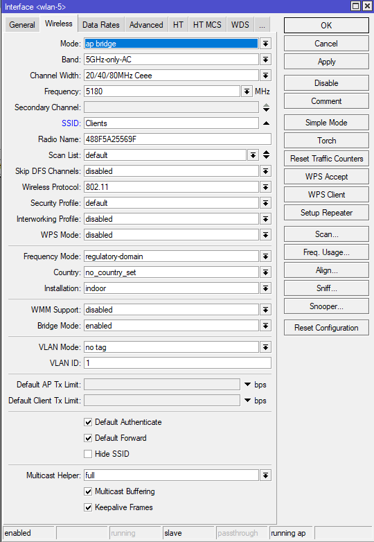

So I just got this new AP and noticed 5GHz wifi is not working. Then I saw some detecting radar crap. The only frequency that works is one that’s already used by the neighbours so that’s not good, is it. How do I switch this crippling “feature” off? I need clean 80 Mhz 5G channel, that’s why I bought this. Thanks
Depending on your location, DFS is mandatory on many channels. Did you try waiting 10 minutes? If a channel is really clean it will start working after the initial listening period.
Try to set the 5 Ghz interface like so:

In addition to the post of @inteq:
  • Set the country code
  • Enable WMM Support
As mentioned, DFS requires some patience (up till 10 minutes) during startup.
One intermediate step is to set “Skip DFS channels” to “10min CAC”.
This will avoid the “weather radar channels” that require the 10 minutes silence and listen before start, and still allow the 1 minute “silence and listen” DFS channels to be choosen.
