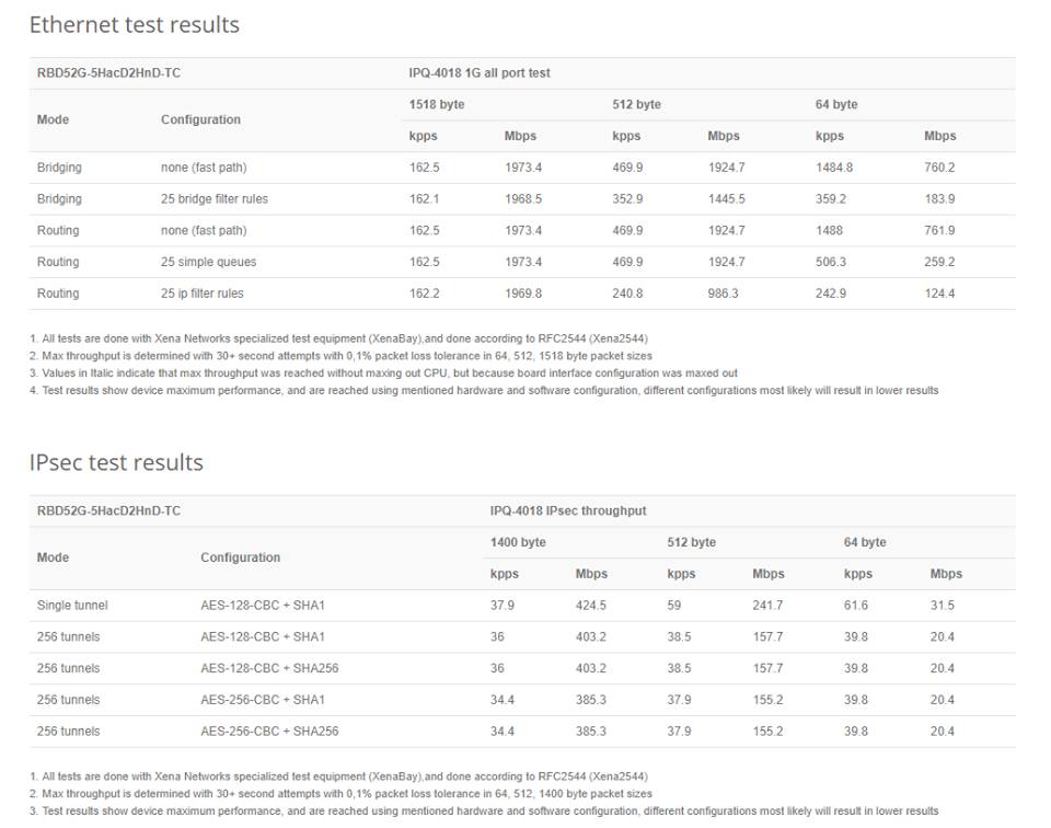

HAP AC2 PERFORMANCE NUMBERS
Somebody from mikrotik can confirm published performance numbers from hAP ac2 ??
https://mikrotik.com/product/hap_ac2
are really impressive!!!
practically wipes the rb3011 !!! (except fast-path and big packet tests)
Yes, these are official test results.

can anybody share wireless performance of hap ac2 vs hap ac?
the comments on cap ac is quite scary and these two products were released (around?) the same time.
looking to purchase a dozen of these but i must be assured they work well.
lso, does hap ac2 support switch vlan / hw offload? this should be updated to contain newest hardware… https://wiki.mikrotik.com/wiki/Manual:Switch_Chip_Features#Bridge_Hardware_Offloading
It’s currently only supported through the switch configuration (switch chip = AR8327), see https://wiki.mikrotik.com/wiki/Manual:Switch_Chip_Features#VLAN_Example_1_.28Trunk_and_Access_Ports.29
i questioned support about the worrying performance on this thread. they suggest to try the latest rc. will you guys give it a go?
