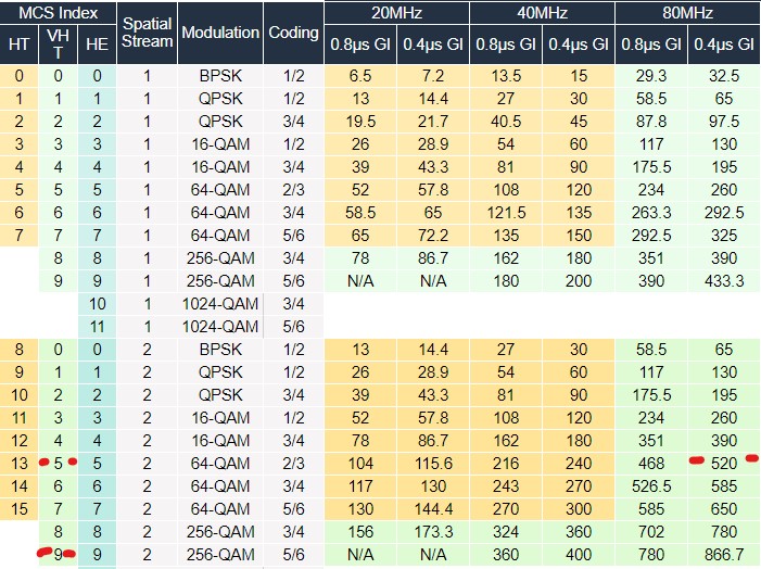

520Mbps does not indicate a clean connection. A lot of distortion and interference is suspected to make the PHY step down 4 times from MCS9 till MCS5. MCS step down occurs when all HW retransmits (standard =7 times) repeatedly fail. So I expect quite low CCQ. (% of successful transmissions), that also reduces with the same % the useable throughput of MCS5 (520Mbps). Overhead is between 25% and 60% depending on many variables. There might be others on the used channels as well, with whom one has to share the airtime.
208 Mbps as @MKX says, is no surprise at all, with a 520Mbps half-duplex PHY speed.
