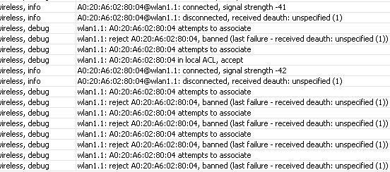

I have installed some hap ac2 with AP and virtual APs.
Today I have found that one of the devices that connects to one of the virtual APs is getting banned:
I have tried disabling temporaly the interface and enabling again, but the device keeps “banned”.
Where is this ban list stored?
Later I have tried unselecting the option “Default authenticate” and including all expected devices in the list, but the logs keep informing me that it is banned.
EDIT: This hap ac2 has installed routerOS 6.47 (not 6.44.1) and has been running great for months
No idea where to find the “banned list”, nor how long it remains active (30 sec? 1 min ? …)
You get in the banned list because of the repeated previous error.
Unfortunately “unspecified(1)= undefined reason” is not very helpful in knowing how to avoid the error. (Linux wifi reason codes can be found on-line, one specified “E.G. no SSID given”)
Eliminate the error and you will not return to the banned list.
“Forget” the known network on the client device before retrying.
Thanks, after trying different solutions all morning with this issue I restarted the client and the error disappeared (it is an esp8266 board, will check it the following weeks if the error appears again)

Same reason in the LOG “unspecified(1)” ?

Indeed, same reason (unspecified(1)).
