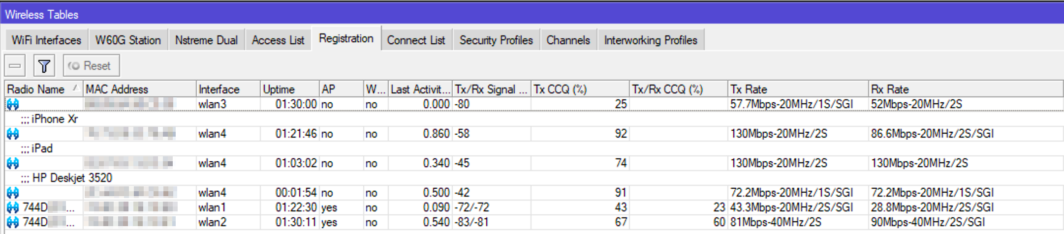

Tx CCQ% on the main unit is below 50% but sometimes can be above 50% (see the screenshot) for 2.4Ghz (connected to repeater) and above 50% for 5Ghz (connected to repeater).

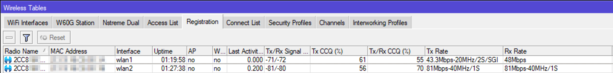

Tx/Rx CCQ% on the main unit is almost always above 50% for both 2.4Ghz and 5Ghz APs, connected to the repeater.
This is for the repeater device.
744D is the main ac2, 2CC8 is the repeating ac2.

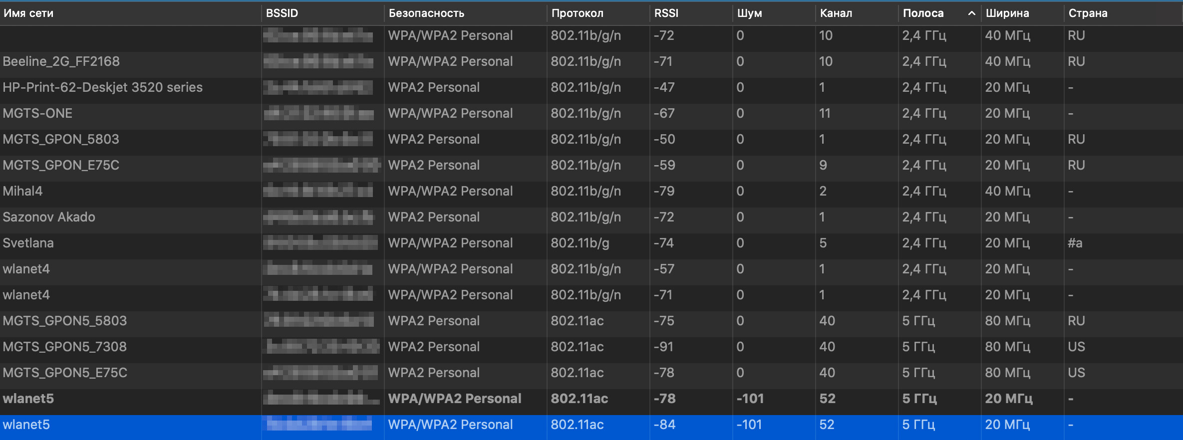

Now the funniest part:
Look at the channels. It’s obviously in Russian but I don’t think it’ll be a problem to read.
All 2.4 GHz SSIDs are sitting on different channels. All 5Ghz SSIDs except for mine has 80Mhz width.
There are also lots of MGTS_GPON SSIDs as you see. I think that one of our internet providers, MGTS, doing a great job - they provide clients with 2.4Ghz/5Ghz capable routers and configure them to “maximum speed” as I guess, so the client will get the wider channel for 5Ghz AP which also locked to a certain channel and 2.4 GHz Ap with automatic channel switch. So here we get a 2.4Ghz environment which is kind of trash quality. That’s part of my problem which I obviously can’t fix by myself =)
That’s definitely a good idea, but I’m not sure it’ll help since only my PC’s adapter sees 11 ssids around and that also means 11 APs, believe me. And that’s for 2.4Ghz.
