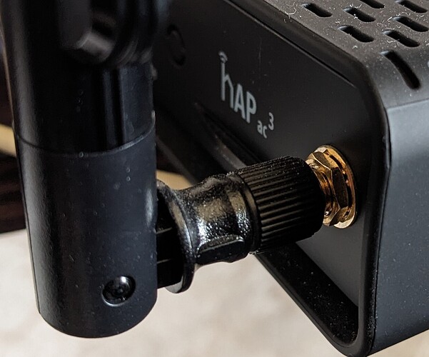

As you can see that is not true. hAP ac³ has detachable antennas but stock antenna gain hardcoded into firmware (according to what I can see). Developers assume one will never attach antennas with lower gain or have losses in feeder lines?

Are we talking about the same device? hAP ac3 has detachable antennas
“hAP ac3” and “hAP ac3 LTE” are different devices
But OP expressly pointed to the “hap ac3” page?
And in post #4 he is lamenting that the value is fixed even if the device has detachable antennas?
Yes, but this device is an indoor device and is certified only for indoor use, this is why such restrictions are there. Normally people want to set lower gain than the actual antenna that is uses, to force higher TX power. This is not allowed.
