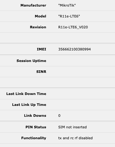

Just tried to configure a brand new hAP AC3 LTE to function as a LTE / 4G router.
But the hAP AC3 keeps saying “SIM not inserted”.
The SIM works perfectly in an iPhone and has worked in another hAP AC3 LTE before.
The device is running 6.48.1 (both packages and routerboard firmware)
Also tried 6.49beta27, same results.
Any thoughts?

Hi guys thanks for the advices!
It turned out to be a physical issue with the SIM-card connector pins, not all pins actually had contact with the inserted SIM-card.
We’ve bended the problematic pins and it instantly worked!
