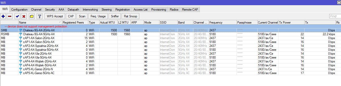

I have the same issue (there is RED alert: “device does not support management protection”) but with Chateau AX with 7.16. I am using CAPSMAN, have also 4x cAP AX but they have previous package 7.15.3 and there is no problem - they are working OK.
It only impacts on 2Ghz on local interface 2Ghz (5Ghz is also OK).
It looks like there is some problem with 7.16, am I right?
It was set many month ago with no changing - it appears last days after upgrading to 7.16
Any one else has also such a problem?
no i was running 7.16 no issues with capsman and 4 capax so it is some thing that your config isnt right
do you have the correct wifi drivers installed
do you have a export of the config so we can have a look pls
I thinks so - it was everything all right till last updgrade (attachement)

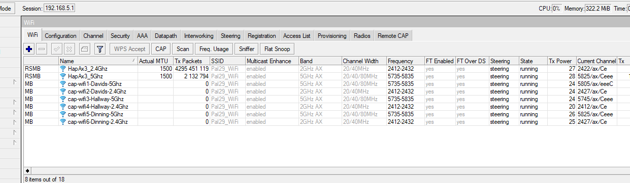

same goes for 5G have a look at my picture i uploaded as devices will pick what there wont to run
i only set up the information in the config tab next to wifi i had all the other ones setup and was having issues and buggy wifi so i removed all the Channel,security tab and ONLY do it in the CONFIGURATION TAB so caps get the same
next i see that your running caertifacates on the caps
i was and found that when the router rebooted the certs didnt work after and i had to muck around with them again as the ap not worked so i removeed the certs all togther
can u show me the wifi like this im no expert but i will try to help you
im running hapax3 and 2 capax and a hapax2 in capsman and all work pretty well

But I don’t have different SSIDs - it’s only one on all interfaces - there are only different names on each of interface/cAP.
I’ve tried not using TABs but there is no difference.
I even turned off all cAPs - and even 5Ghz interface, just let only one 2,4Ghz be ON - it is still error on this interface.
With or without CAPSMAN also.
Also removed certs - no progress…
I found in the TESTING version 7.17 BETA there is 802.11h disabled for 2,4Ghz - maybe this is the issue?
What is the point of running WPA2 and WPA3 on same network at same time? It doesn’t matter that there are some clients connected over WPA3 when there is WPA2 still available. Security of your network is always the lowest one = WPA2.
Now you know that your WPA3 is pointless so and you can disable management protection. Solved…
