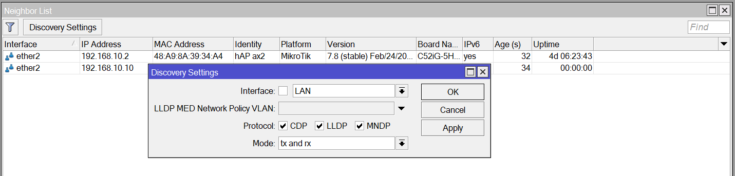

Hi, maybe it’s something you changed because in my hAP ax^3 (ROS 7.8 ) and hAP ax^2 (ROS 7.8 ) the default is this:
You are correct. My default was “LAN” and I can only offer memory lapse as an excuse.
It doesn’t affect the solution, however.
