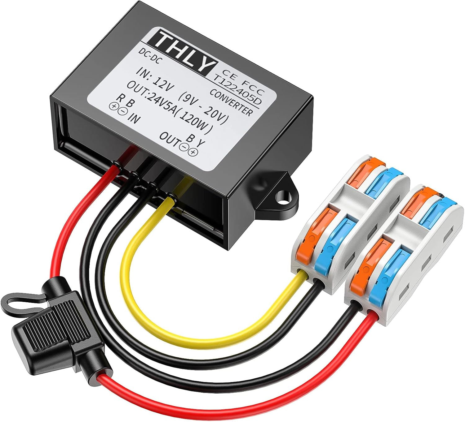

Why cannot you use the simplest solution, a splitter/converter?
power converter?
I’m really went to my limit on power in this Van. I have over 50+ DC power runs. Each new power supply, draws another 5W or more… I’m trying to ulilize what I already have, without re-inventing the wheels.. :slight_smile:
This whole thing is to get a single networked server device, into my network that will NOT connect to my current WiFi (no one knows why). Next thing I know, I’m thinking of setting up a secound WiFi AP just to connect this deivce, and next thing you know, I’m going well over my power limits with watt draws. humm..
ps. I just thought of something, since I have a RasPi running on this network, perhaps I can just activate the WiFi on that RPi and connect my device.
Each solution I come up with, is met with something that goes over my spending, goes over my power requirements, or is NOT reliable. lol
I think I didnt understand what the splitter/converter did… It actually doenst plug into a power source, but it plugs into the thing your trying to power??
