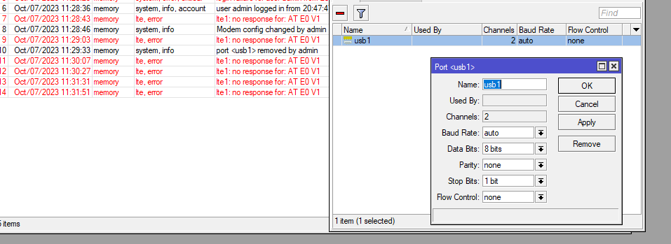

The log says
LTE1: no response for: AT E0 V1
Lots of posts on Forum eith the same problem. Same SIM in the new device works without problems.
Any idea?
No usb2 modem, no serial port, usb1 removed for test, recreated by router after restart.

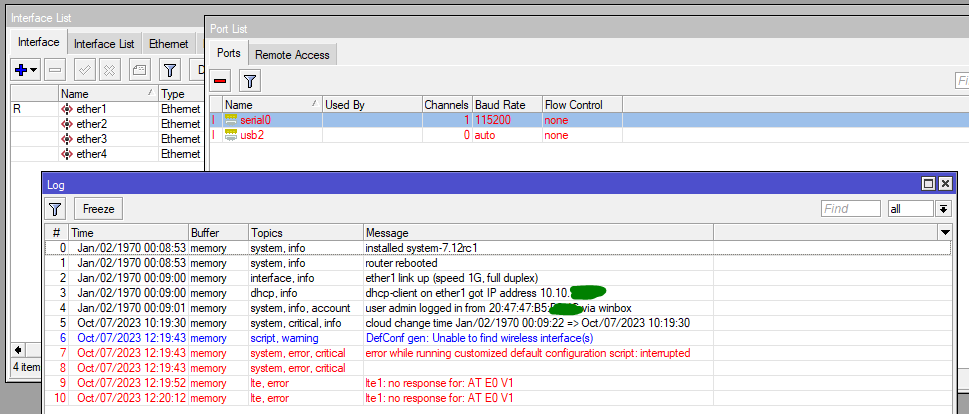

Netinstall did not help, even worse … serial0 and usb2 flaps :frowning:
And where is wifi interface ??
package wifi2 not installed .. no need at this moment

No change … reset, upgrade, downgrade, reset, power on, power off .. so many tries … tired trying.
LTE is missing … Fibocom USB device is on a list of devices then vanish … resurrects … USB2 flaps … no interface no matter what combination of above steps is taken.

The logs kinda make sense since defconf waits ~30 seconds looking for wireless interfaces and, if none, it does a log and /quit. But that failure doesn’t explain not finding LTE, since the defconf does not create the LTE interface or do anything with LTE.
Actually it does do “something” but creating them, that it doesn’t do.
(e.g. it does add it to WAN interface list, looked it up in default config for AX Lite LTE :laughing: )
True. And, firewall be missing too since wireless check happens early, but failure should actually get you a blank config anyway (@holvoetn, see “revert” part at bottom of /system/default-configuration). I have every faith that @BartoszP can build a config if that were the problem here :wink:. It’s the “no response for: AT E0 V1” that’s seems like Mikrotik bug.
