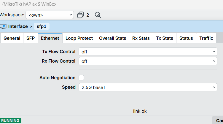

I want to use this to establish a 2.5 Gbit fiber connection indoors with the router in the basement, the [CCR2004-16G-2S+], which has an SFP+ port and is also compatible with SFP. I have been searching for a few days now to find out how to do this, which modules support it, etc., but I can find little to nothing. I do find information everywhere that if a module supports this, you have to set it to 2.5 Gbit yourself, and that this does not work with auto-negotiation.

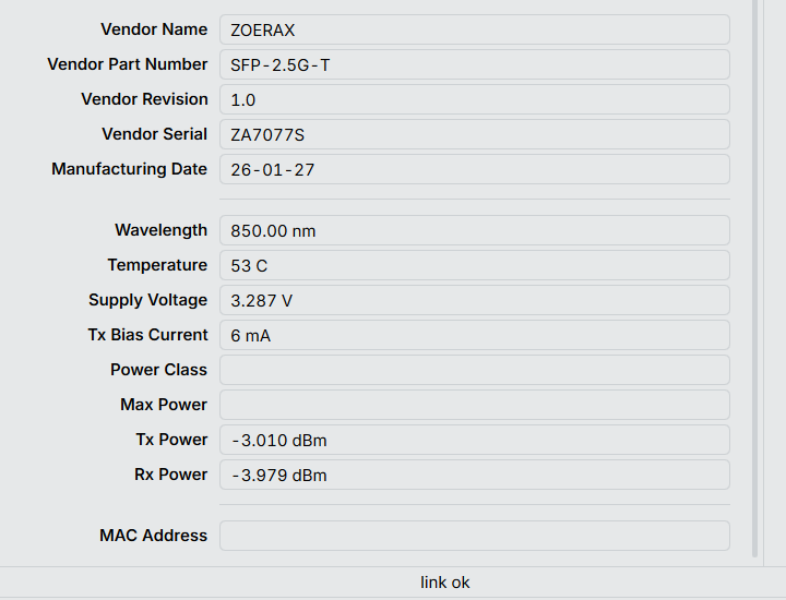

I'm using four of these in 4 hAP ax S used as cAP:
HORACO HC-2.5GE-SFP
ZoeRax SFP-2.5G-T
For the problem described here: hAP ax S low upload speed with 2.5G ONT
