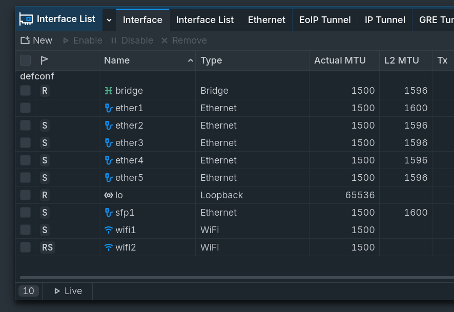

I just bought a new hAP ax S. I am trying to set it up for the first time, but Ether1 seems to be dead.
There is no LED light on Port 1 when a cable is plugged in.
In WinBox, the interface stays at "no link" (no 'R' flag).

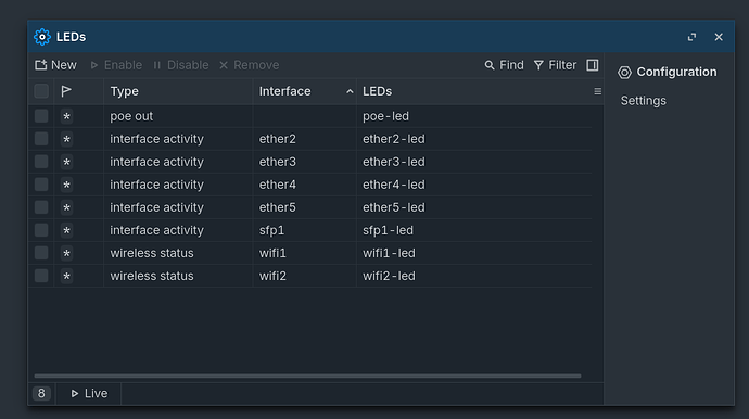

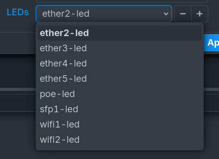

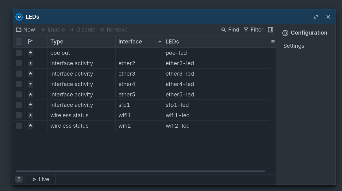

In the System -> LEDs menu, ether1 is completely missing from the list, while all other ports are there.
The cable and modem work perfectly when plugged into Port 2 or Port 3.

Is there any software setting that could cause the port to disappear from the LED list, or did I receive a unit with a faulty hardware controller for Port 1?

Just want to mention that based on the block diagram, port 1 is connecting directly to the CPU, not the switch. Also, I updated the firmware to 7.22.3 but port 1 still doesn't work.
If interface activity does not show an active link, why do you think ether1-led should light up ?
It might indicate a defective port (especially if you say that same cable does work for ether2 or ether3).
Yes, ether1-led is missing from led menu, that's true as well on my hAP AX S sitting here next to me with a blinking led on ether1 ...
I would RMA that device.
