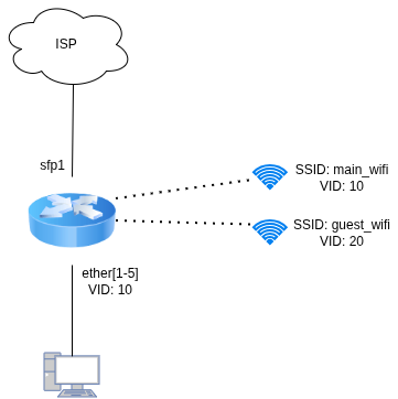

I just bought my first Mikrotik for home use and after reading multiple guides I’m still struggling with the vlan setup.
The design is pretty simple, all the ports and the main wifi on vlan10(10.0.10.0/24), then a guest ssid on vlan20(10.0.20.0/24), both with access to internet but isolated from one another.

No need to put your main wifi on a vlan. Yes, every document you see does this, but basically you only put something on a vlan when you can articulate a need. At this stage, the only need we can articulate is to put the guest wifi on a vlan to keep guests separate from the main lan. So just do that. Leave your main wifi on the native lan. As you are new at this, only ever do one vlan at a time.
And then, hopefully, you will never again commit all your interfaces to a vlan. It is generally recommended to leave 1 ethernet port alone and not involved in vlans for precisely the situation you are in, so that you can get back into your config. You now have the more immediate problem of how to get back in. You might prefer to do a factory reset - or if you have a linux box, you can use Network Manager to set up a network connection on vlan10. Perhaps you can do the same from Windows too, but I don't know.

Firstly, the author wrote a diagram and asked how it should work, and the answer was given. What he wants to do and whether he needs any more advice—we don't know, and we're not interested. I hope he's doing well.
Secondly, there shouldn't be any MGMT, VLAN isolation across horizons, or bridge filtering. This is all nonsense. Because the web interface is inconvenient, and the author will have to configure everything in WinBox, which a) securely encrypts the connection, and b) requires a password of 16 or more characters, which we a priori consider impossible to crack.
