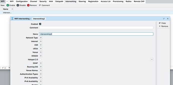

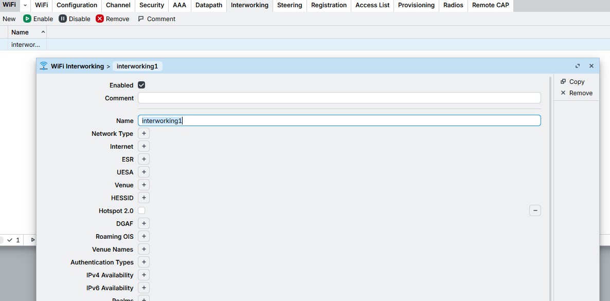

As a result, the access point worked more stably, but I noticed that the inscription HotSpot 2.0 appeared next to the SSID.
I have not configured or enabled HotSpot 2.0 anywhere.
It seems that this was "pulled" from the default settings.
I tried to configure it from different versions of WinBox: versions 3 and 4 - the inscription HotSpot 2.0 always appeared
I solved the problem: created a profile in the Interworking section, where I set and disabled the HotSpot 2.0 parameter.

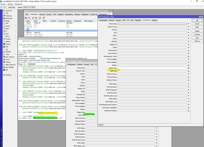

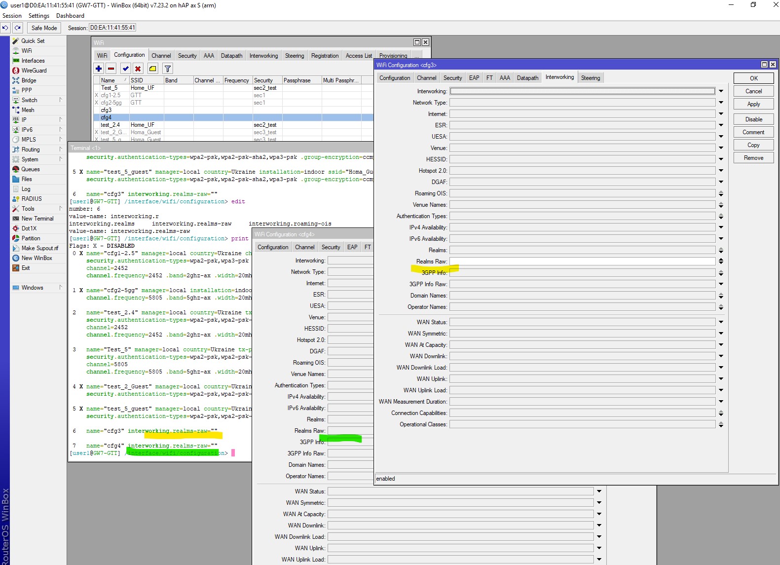

I see the interworking.realms-raw in your export. You need to unset that on both interfaces. see iOS 26.4 cannot connect to the hAP AX3 + CAP Wi-Fi; the iPhone only works with the default AX3 router configuration - #12 by rialtresh
How can I do this from WinBox? I don't see this option in either version 3 or 4.
Can only be done from terminal.
Thanks for the tip. I deleted interworking.realms-raw.
In interface 3.43 and version 4 the parameter exists, but its empty value is not displayed.
I removed it in version 4 like this: I specified the value, then deleted it.
I also created a situation: cfg4 was created in WinBox 3.43 (where the parameter was added), and cfg4 was created in WinBox 4. Everything is very strange. The text portion of the configuration is identical. Even the files obtained via export are identical. But some things are "visible" in the windows, while others are not.
Что, куда и как пишет WinBox
Oh, I was able to reproduce the bug with interworking.realms-raw in version 4!
If you create a configuration from the command line, this parameter is not visible in the WinBox interface :)))))
/interface wifi configuration add disabled=no interworking.realms-raw="" name=cfg1
And if you perform the same actions from the WinBox 4 interface, then everything is visible.
There's a video. Looks like you need to send it to tech support.
The problem with the interworking.realms-raw parameter not being displayed in the interface exists in WinBox version 4 and in the settings web interface.
Both on the current Stable branch (7.23.2) and on the RC branch (7.24rc3)
Technical support confirmed the bug, but there is no time frame.
