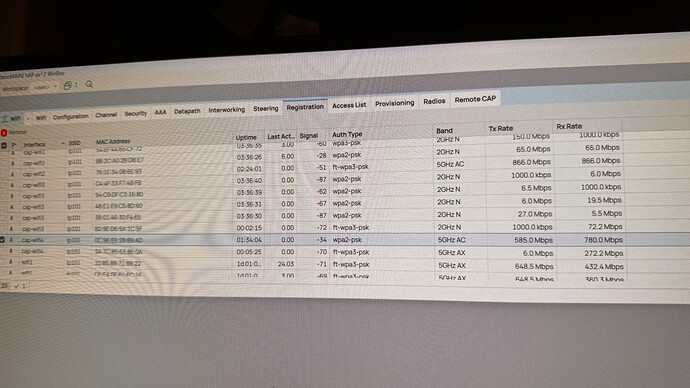

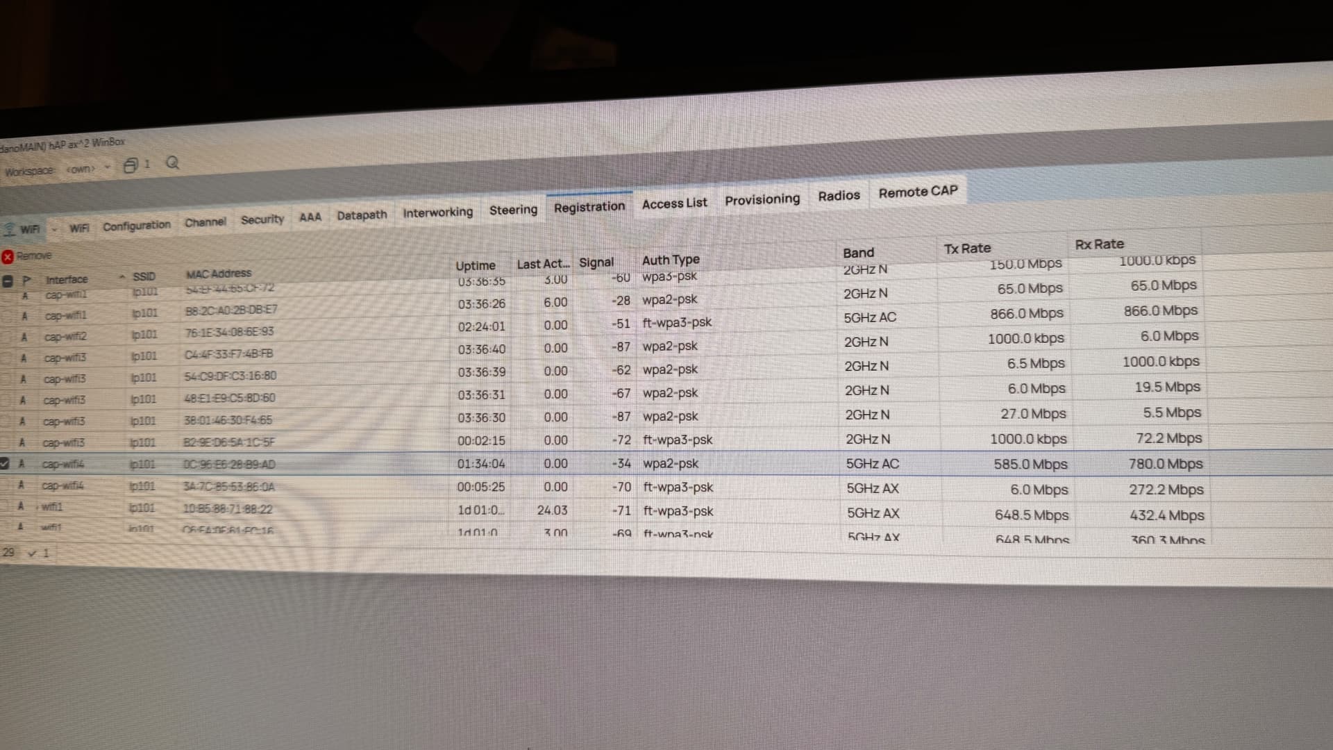

At what rate is the client connected to the hAP AX S? Any difference from the other CAPS's?
Wided connection on hap axs is full speed 500/100 as my isp maximum. Its only wireless issue.
Assuming you are replying to me...data rate of the wireless connection of the client. It can be found (in Winbox) on the Registration tab of Wifi. It will provide information about the radio the client is connected to, as well as Tx Rate and Rx Rate. These two is what I'm looking for.

Rates look okay, at least you should be able to get well over 100Mbps.
