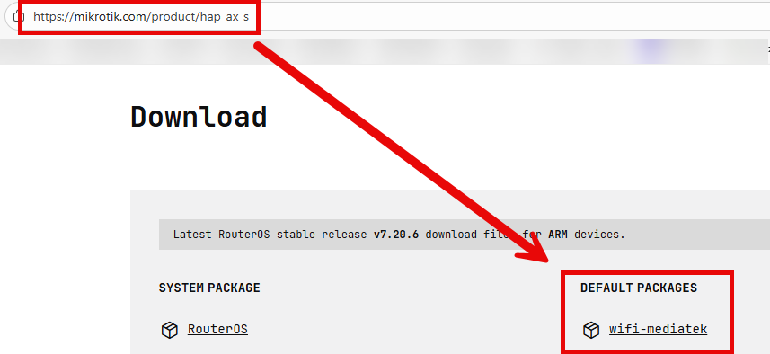

Is the wifi-qcom package installed on hAP AX S?
Shouldn't that be wifi-mediatek ?
Hap AX S uses Mediatek drivers, not Qualcomm.
