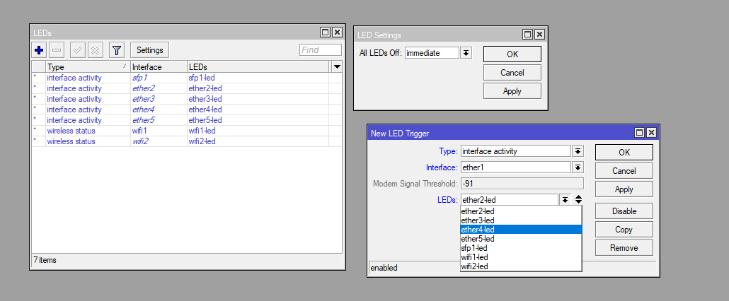

I am not able to turn off interface ether1 activity LED via WinBox, since there is no such triger.
Model name hAP AX S (E62iUGS-2axD5axT)
RouterOS 7.21
Setting All LEDs Off: immediate does not help
RouterOS 7.21

Yes, have tried to set all leds to “off“ - does not help, ether1 still blinking. Maybe someone with hAP AX S device can check it, if this problem exist?

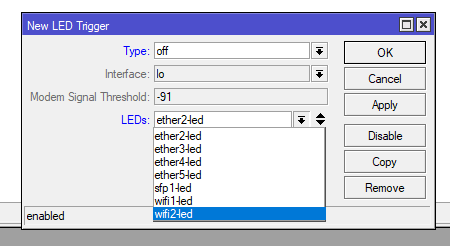

When trying to create trigger, the LED “ether1-led“ does not exist at the list (as shown on the screenshot)
Did you use “all leds off” in the “settings” button, or did you select “type: off” in that open dialog and save it?
Tried both variants.
But there is no such option “ether1-led”.
All ports LEDs are turned off now except Ethernet 1.
Apparently the ether1 led cannot be software turned off.
