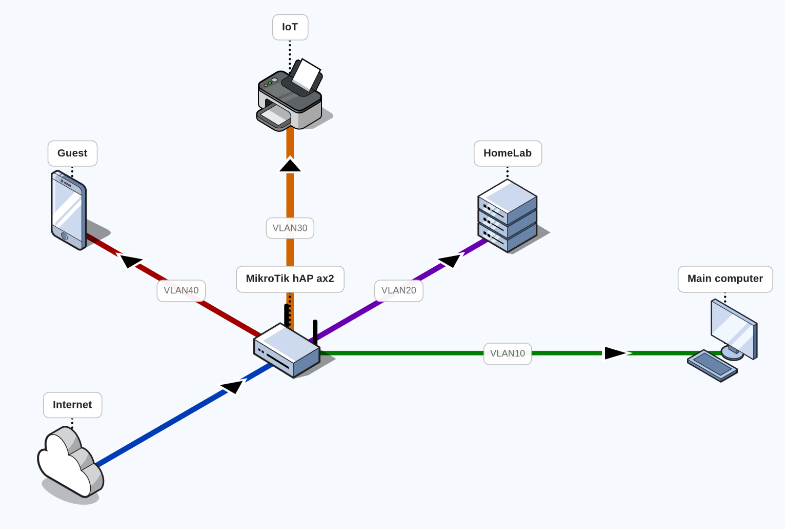

Hello guys,
I hope y’all are well and that this is not against any rule. If so I’ll remove this post.
I am completely new to MikroTik (~2 weeks old) with (very) limited networking experience.
I bought a MikroTik hAP ax2 to have a better ownership of my home network, and support a company providing the kind of hardware/software support MikroTik does.
I wanted to:
  • Enable VLAN filtering, having 4 VLANs (for main, homelab, IoT, guests)
  • Have 4 access points, one per VLAN
  • Have custom firewall rules across VLANs
I know (think?) my setup is pretty standard, but I couldn’t find anyone doing it as I do. I went through the forum, countless youtube videos, other people’s configurations and the documentation (e.g. Using RouterOS to VLAN your network ). I managed (after getting locked out way to many times) to setup my config as I wanted to, and it seems to work as I intend it to.
However, I know that I cannot judge whether I accidentally made a dumb mistake and let my router with an open hole allowing external access, especially since I tweaked the firewall rules.
I am running RouterOS 7.21 (stable).
Below is my config

Would anyone be kind enough to help an afraid noob ?
I am mainly concerned about having a huge hole in my firewall.
Thank you very much

add address-pool=pool-main interface=vlan10-main name=dhcp-main
add address-pool=pool-iot interface=vlan30-iot name=dhcp-iot
add address-pool=pool-guest interface=vlan40-guest name=dhcp-guest
add address-pool=pool-homelab interface=vlan20-homelab name=dhcp-homelab
add address-pool=pool-ether5-mgmt interface=ether5-mgmt name=dhcp-ether5-mgmt
/disk settings
set auto-media-interface=bridge auto-media-sharing=yes auto-smb-sharing=yes
add bridge=bridge comment=defconf frame-types=\
    admit-only-untagged-and-priority-tagged interface=ether2 pvid=10
    admit-only-untagged-and-priority-tagged interface=ether3 pvid=10
    admit-only-untagged-and-priority-tagged interface=ether4 pvid=10
    admit-only-untagged-and-priority-tagged interface=wifi1 pvid=10
    admit-only-untagged-and-priority-tagged interface=wifi2 pvid=10
add bridge=bridge frame-types=admit-only-untagged-and-priority-tagged \
    interface=wifi1-homelab pvid=20
    interface=wifi2-homelab pvid=20
    interface=wifi2-iot pvid=30
    interface=wifi2-guest pvid=40
set discover-interface-list=MGMT
add interface=vlan10-main list=LAN
add interface=vlan30-iot list=LAN
add interface=vlan40-guest list=LAN
add interface=vlan20-homelab list=LAN
add interface=vlan10-main list=MGMT
add interface=ether5-mgmt list=LAN
add interface=ether5-mgmt list=MGMT
add address=192.168.10.1/24 interface=vlan10-main network=192.168.10.0
add address=192.168.30.1/24 interface=vlan30-iot network=192.168.30.0
add address=192.168.40.1/24 interface=vlan40-guest network=192.168.40.0
add address=192.168.20.1/24 interface=vlan20-homelab network=192.168.20.0
add address=192.168.55.1/30 interface=ether5-mgmt network=192.168.55.0
/ip dhcp-client
add comment=defconf interface=ether1
add address=192.168.10.0/24 dns-server=192.168.10.1 gateway=192.168.10.1
add address=192.168.20.0/24 dns-server=192.168.20.1 gateway=192.168.20.1
add address=192.168.30.0/24 dns-server=192.168.30.1 gateway=192.168.30.1
add address=192.168.40.0/24 dns-server=192.168.40.1 gateway=192.168.40.1
add address=192.168.55.0/30 dns-server=192.168.55.1 gateway=192.168.55.1
set allow-remote-requests=yes
    established,related,untracked
    invalid
add action=accept chain=input comment="MGMT to router: ACCEPT" \
    in-interface-list=MGMT
    "LAN to router (DNS, DHCP, NTP): ACCEPT" dst-port=53,67,123 \
    in-interface-list=LAN protocol=udp
add action=accept chain=input comment="LAN to router (DNS via TCP): ACCEPT" \
    dst-port=53 in-interface-list=LAN protocol=tcp
add action=drop chain=input comment="any to router: DROP"
    ipsec-policy=in,ipsec
    ipsec-policy=out,ipsec
    connection-state=invalid
add action=accept chain=forward comment="MGMT to LAN: ACCEPT" \
    in-interface-list=MGMT out-interface-list=LAN
add action=accept chain=forward comment="LAN to WAN: ACCEPT" \
    in-interface-list=LAN out-interface-list=WAN
    in-interface-list=WAN
add action=drop chain=forward comment="any to any: DROP"
/ip ssh
set strong-crypto=yes
/ipv6 firewall address-list
/ipv6 firewall filter
    invalid
    icmpv6
add action=accept chain=input comment="defconf: accept UDP traceroute" \
    dst-port=33434-33534 protocol=udp
    udp src-address=fe80::/10
    protocol=udp
    ipsec-ah
    ipsec-esp
    !*2000012
add action=fasttrack-connection chain=forward comment="defconf: fasttrack6" \
    icmpv6
    500,4500 protocol=udp
    ipsec-ah
    ipsec-esp
    !*2000012
/system clock
set time-zone-name=Europe/Zurich
/tool bandwidth-server
set enabled=no
/tool mac-server
/tool mac-server mac-winbox
set allowed-interface-list=MGMT
/tool mac-server ping
set enabled=no
The management port, only requires the address, there is no need for pool, dhcp or dhcp-server settings. They can be removed.
If not using IPV6, then one can disable IPV6, and remove all the associated firewall address lists and firewall rules. I only keep two
forward drop all
Input drop all.
@ OP
Please remove device serial number from export before posting !
(surprises me a bit none of the others have mentioned this, they usually do)
I've cleaned up all three occurences above.
Thank you @holvoetn for censoring the serial number; I'll make sure to remove it in future posts
I've disabled IPv6; thank you all for the kind help
Please confirm its all working as required now!
All is working well; the previously-shared config works perfectly.
I added the ipv6 disable-ing but that's it.
Thank you all for the help.
I have marked @erlinden 's answer as the solution, but thank you @anav for the precious help
