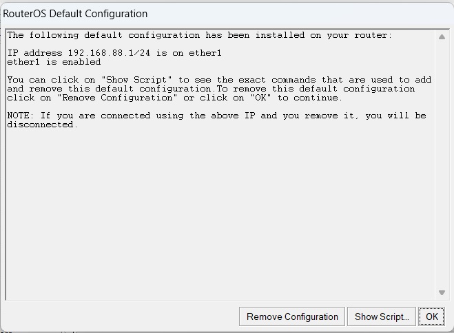

After netinstall i get this when first powering the router on:
There is no more normal default configuration for some reason no matter what i do… aaaaaand there is no wireless interfaces at all… on both routers… i really don’t know what is wrong now…
is the wireless package installed?
It’s not… I forgot that… Thanks, i will install it. But i still don’t know why i don’t have default configuration…
Netinstall went without a problem…
So i tried to downgrade to factory 7.5 ROS and then netinstall it, i tried to tick apply default config and nothing… Stil same “default” configuration…
Did i screw something up ? I mean i did netinstall on RB4011 and HexS before and everything was just fine…
Update: it’s working now, i didn’t include wifi package and that seems to be a problem. Now both devices are netinstalled ROS7
