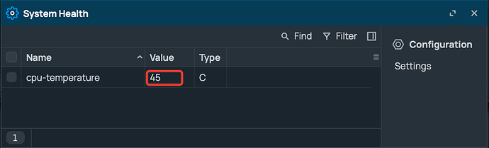

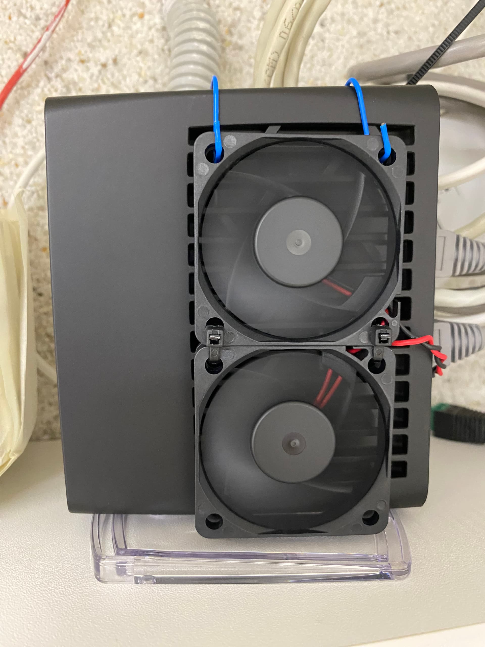

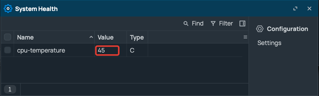

Hi. I made this kind of cooling. The temperature is around 45 °C. I used these fans: Sunon MF50101V1-G99-A (MF50101V1G99A)12v 0.84W 50x50x10мм 3pin. I upgraded by removing the yellow control wire and made a serial connection of the fans.
And here comes the usual question:
Do the fans blow environment air inside the thingy or do they extract (warmer) air from it?
Hi. It is pumped from the environment into the device. Fans blow on the radiator.

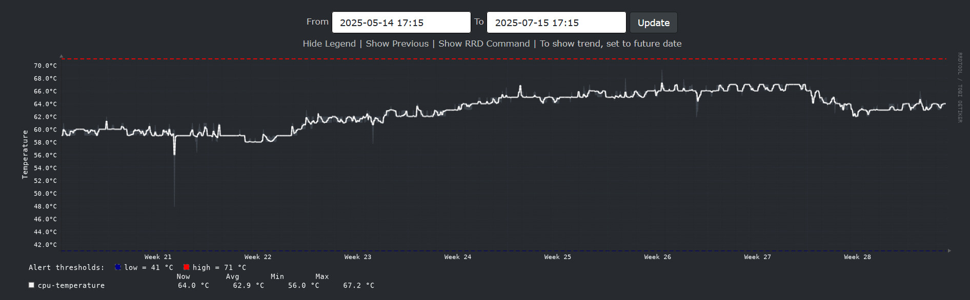

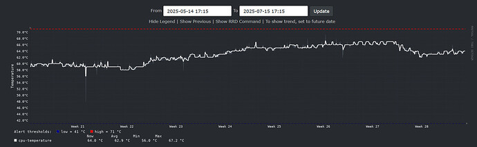

It’s very hot. Can you tell us how to get such a schedule?
i use librenms (snmp) to monitor all my mikrotik…
but i will use zabbix or mikrotik dude…

@aleab
You should give some context to it, in Italy it has been exceptionally hot end of june/beginning of july, so your graphic is not surprising.
But 65 or 66° while “hot” should not be a real risk for the lifetime of the device.
Generally speaking electronics that stays at max 55° or so and the (very approximate and conservative) rule of the thumb is that every 10° C increase you halve the life of the device, have a much longer lifetime, but the real world lifetime (for other reasons, new standards, higher speed, etc.) of a device like these is normally much less than what they can last, even at slightly higher temperatures.
Just a bit of perspective.
For these CPUs the detailed specifications are usually only available under NDA, so not publicly. The usual spec for (absmax) Tj is around 125 degC. It is usally advised to design them to run them at around 95 degC max, so the temperatures posted here are absolutely normal. The usual temperatures discussed on the internet apply to high-end (in the semiconductor manufacturing business sense) processors - for several reasons much lower limits apply to them.
Take into account that these are the temperatures of the actual Si die. The packaging has significant thermal resistance. It’s not generally known, but packaging is actually responsible for a significant portion of an IC’s cost, and therefore manufacturers try to get away with the cheapest option possible. Taking into account the fact that in these operating conditions the die itself basically doesn’t age, this is not a bad thing.
So 65 degC is a totally normal and safe operating temperature for these devices in normal (indoors, not air-conditioned) situations and is no cause for worry.
The usual rule of thumb of +10degC->half the lifetime based on the Arrhenius equation is a usual way to estimate lifetime. However this only applies to components (or their soldered connections) which actually show temperature-related aging in the operating regime. For these devices this is basically limited to the electrolytic capacitors. Fans help with this, but - as a purely personal choice - I rather choose to replace them every 8-10 years than mount a fan.
