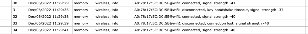

Hap ax2 with 7.6
p.s. in the log I see a lot of connected/disconnected pairs of devices. Added a few lines as example.
