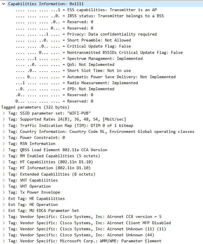

I don’t have a macbook with me today, but I’ve given it a shot and tried to sniff with ax2 itself. I definitely don’t know what I’m looking for, but I thought I’d ask. Would a broadcast packet from AP be sufficient to understand what AP is expecting of a client trying to connect to it? I will probably be able to record the whole communication tomorrow or early next week, but in the meantime, I’ve attached the broadcast pcap file with that single broadcast packet that seems to be repeated a lot. In case it really does mean something for an expert.
The reason I’m asking is that I see some capabilities encoded in there.
