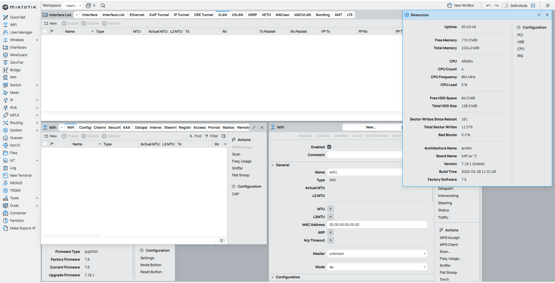

hAP ax2 upgrade to 7.18 don't have interface wifi
Hi all
i have one hAP ax2 run normal with full function, but when i update to 7.18 , the wifi interface was loss, don’t have interface wifi1, wifi 2.who can tell me what happen going on ? why my wifi is loss, don’t appear on interface tap? although it still work normal at 7.10. can you tell me how to get wifi working again ? . note : i have try reset config with and without default config are the same, no wifi interfate ? only downgrade to 7.10 or lower the wifi appear again ?
thanks all

At around 7.13 the wireless drivers were shuffled around. You need to install the “wifi-qcom” package.
On your device you can do this by going to System->Packages, click “Check for updates”, (a lot of packages should appear greyed out), you then select the package “wifi-qcom” and enable it, then click “Apply changes”. This will reboot and your interfaces should magically appear.
(If you’re new to the device, I would also select the “zerotier” package just in case you will want to play around with it.)
you are right, in the packages have two wifi packages and wifi-qcom is disable, so i have uninstall two wifi package and reinstall only wifi-qcom , the router can get interface wifi. But it only run about 4 minute then router auto disconnect all service are loss. the link speed down to 10Mb on all port , can not login router again, can not get any from router :confused: :confused: :confused: :confused: :confused:
