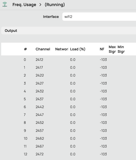

Something interesting I just noticed: even running a “Scan” with wifi2 (the 2.4GHz interface) returns nothing, even though I just turned on a 2.4GHz AP nearby. Further, if I run Freq. Usage, it also appears to be flatlined! See below, taken while I have a device connected to the 3rd party 2.4GHz AP.

Any way to check for signs of life with this radio?
OMG. I’ve spent a week on this. Rebooting, reseting, upgrading, configuring every last inch of the configuration. Chains and channels and masters and slaves and countries and bands. Trying everything I can find in every corner of the Internet. I now have routers and cables strewn from one end of my lab to the other taking readings and advertising networks. The 2.4GHz has been stubbornly dead dead dead. Not just transmitting (eg. scans from external devices show nothing from the hAP) but receiving as well (eg. running a scan/sniff from Webfig shows nothing). Yet no errors appear and all the config seems to take effect in the GUI.
In great desperation, I just tried an ol’ trick from the bottom of the toolbox. I pulled the power plug out. When I plugged it back in, everything was working fine.
That, plus the hundred weird software quirks I ran into along the way don’t fill me with a lot of confidence. But I’m ecstatic to be up and running again! Hope that super smart trick helps others too.
