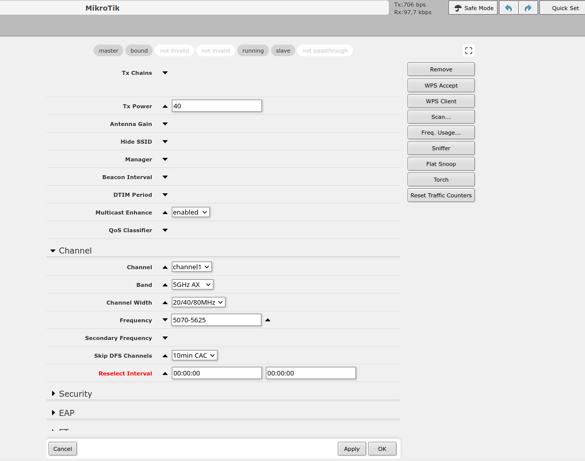

Quick prehistory. Carrier is Orange Polska Sp. zoo. All was good, router from them was super (stable link with 2.4 Gbit/s link), but they deployed a spyware on router and backdoor. I was told a lot of stuff how good MikroTik is, so decided to try. No spyware not, but wifi link is awful, really awful. So if support/dev team is here I need help. Later firmware 7.15 Beta 9. First of all channel select settings are crazy complicated. Need instead a list like channel 1 up to whatever is there possible and manual select of channel (enforced mode). It always tries to stick to some 5.68 GHz and then only 300mbps max, so had to set allowed below that to avoid. So the problem is, technical specs state as warranted 1200mbit/s, is fact max I get 960 Mbit link, and actual speed below that. And by tech specs it’s declared as AX1800, which means it should support up to 1800mbit/s link, but probably locked by firmware, which is time to unlock then.
Problem is I have 1Gbit fiber and it was max like that (stable) on previous carrier router, but problem was spyware.
This router is better as no spyware, but worse due to router being at maximum 5-6 meeters away from router and fails to get even stable 1200 mbit link. Test results are here https://www.speedtest.net/result/16086764065 .
I need at least 950 mbit/s link, as I am working with servers (mean work remotely with servers) and whole link needed for backup downloads etc. If that don’t get fixed it’s a first and the last time I’ve ever tried MirkoTik. Promotion from friends about this vendor and expectations were much higher that it acts in fact. And no option to manually chose channels from list and force routed pick what I want, not what it decides is good.
. Screenshot of wifi settings attached. I need stable minimum 1200 mbit link and minimum 950 mbit/s actual transfer speed. Wifi card shows power jumping and link speeds jumping from 800 to 960 mbit/s link, but never gets maximum 1200mbit. Also on screenshot you can see newly added field some “reselect interval” and I don’t know what it wants but prevents from saving settings. Jumping from channel to channel is also not good. It must allow manually select from some drop down menu precise channel on my own choice and lock it, so that I can take something not used by neighbors. And minimum 15 meeter coverage for whole flat is also mandatory.
Thanks for any help and firmware fixes in advance.
As already told in terms of privacy router seems good, in tems of speed and link quality average, which is not enough.
