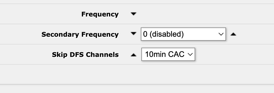

Check the status of Wi-Fi interface, by default it often goes DFS 10 minutes when staring, it will now allow connections before finishing DFS.
You can change it in the config to skip 10 min DFS or skip all DFS channels
It’s set to skip 10 min cac:
.skip-dfs-channels=10min-cac
And from the WebFig UI:
Or do you mean something else?
