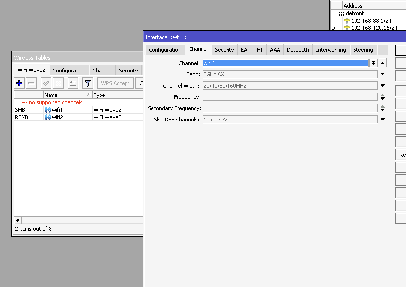

ahahah well I just wasted 2hrs trying to get 160MHz working given the drop down in the channel config box allows you to select 160MHz.
I’m glad I found this forum thread!
