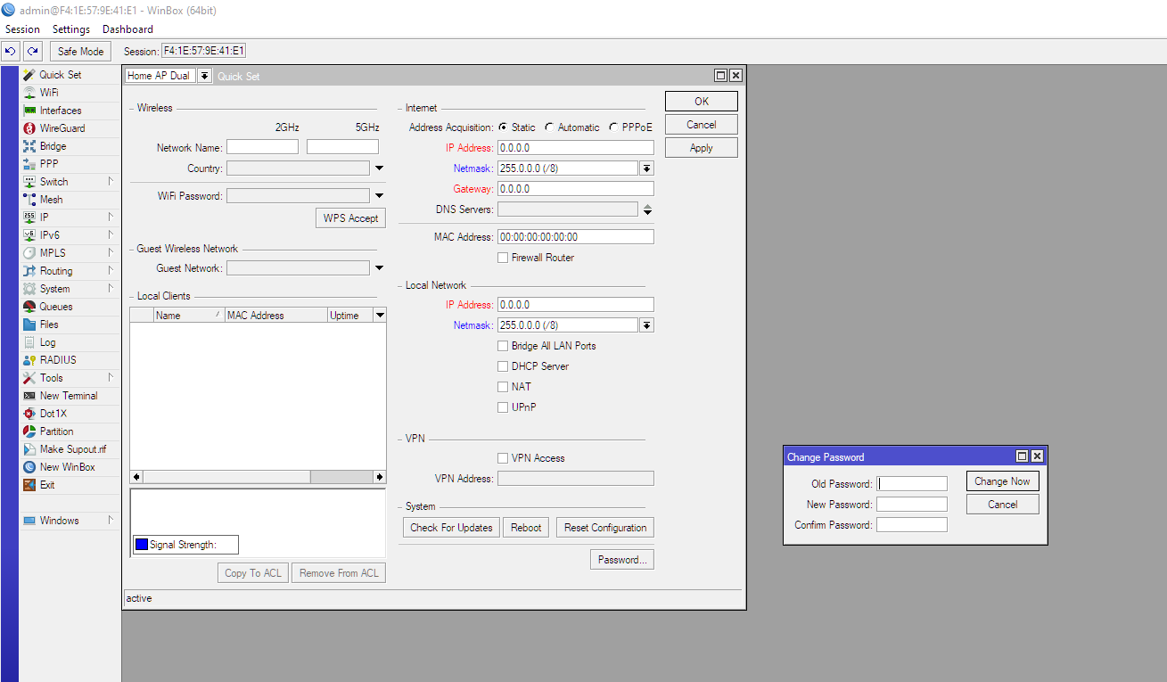

With Winbox 3.43 no errors appear, but it loads the interface, displays this then drops the connection off:
Attached two captures for the winbox 4 and 3.43, not sure if this is helpful

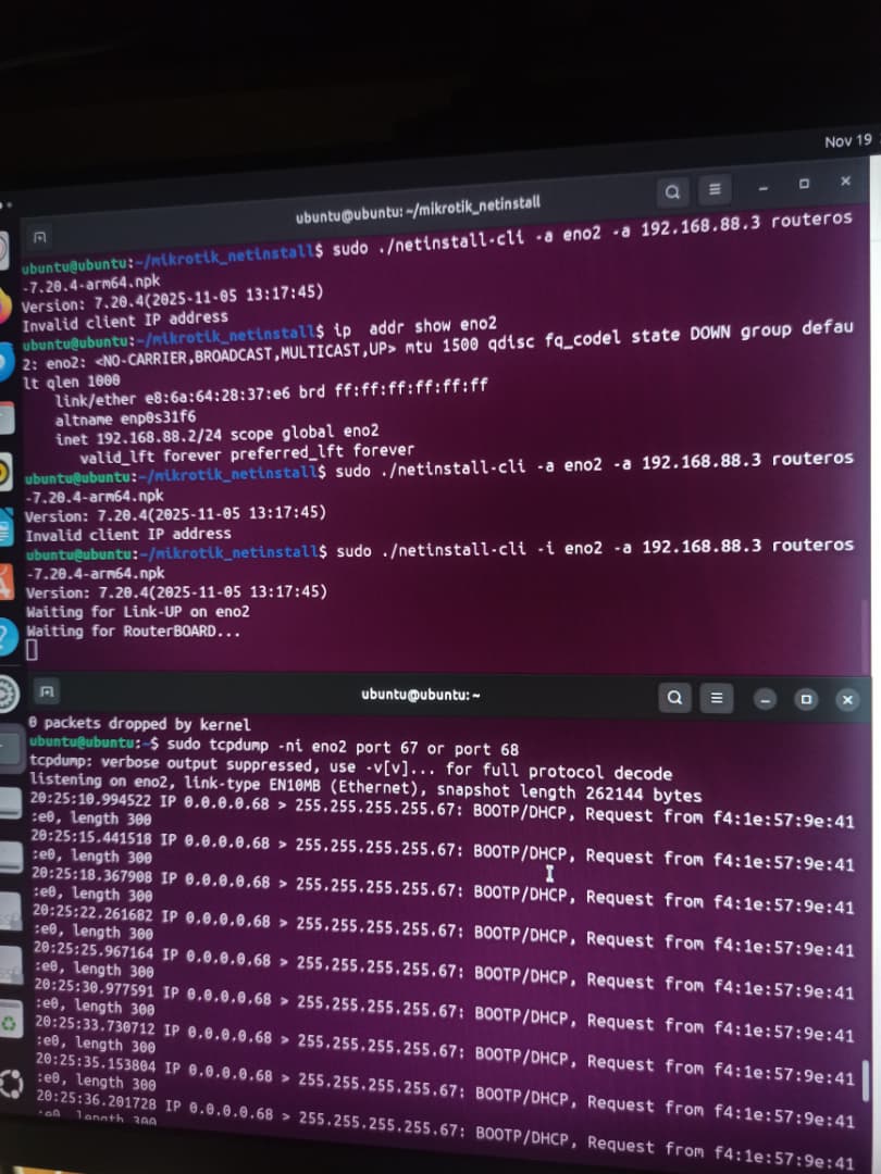

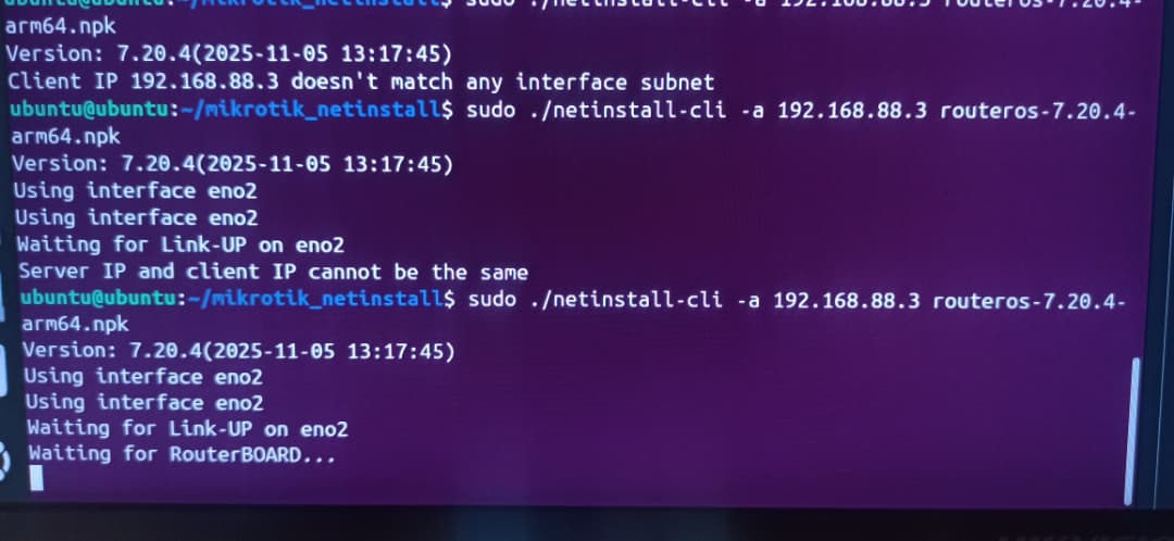

since raspberry pi is not supported I launched my USB with ubuntu 24, ran the netinstall cli, router doesn’t responds to the commands..

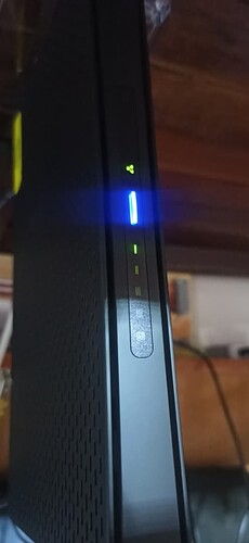

this image is the router status after any of the boot types:
  1. remove the power cable
  2. press the reset button
  3. first led status(fixed blue I think), first boot type
  4. second led status(blinking green or yellow), second boot type
  5. third led status(stopped blinking, fixed green or yellow), third boot type
  6. release the button
I tested, the third boot type, also tested first type, then third type…
please confirm me the death, and the departure to the router dimension. So I can proceed with the funeral arrangements.

Same steps. Hold it for 7 seconds (between 5-10), and it go to defaults — that really should work without netinstall. MikroTik suggests Hold this button until the LED light starts flashing, and release the button to reset RouterOS configuration to default., but I just wait 7 seconds.
If you want to netinstall, hold for at least 15 seconds. There is no 1st boot, 2nd boot, etc., there are just different modes, CAPsMAN mode that happen between 10-15 seconds.
But in all cases it is absolutely critical the button is pressed when power is re-applied - which can be tricky logically.
Finally keep in mind, you'll need to use Wi-Fi or ether2+ to access the router after it goes to defaults, since ether1 will be firewall protected.
I did that for 20 seconds, same results
I ran tcpdump and I’m seeing the incoming packets from the router, that is happening from the port eth5, doesn’t happen on port eth1 from the router..
this was pressing the reset button for at least 15 seconds, and, without the reset button pressed, it outputs the same. So it is the natural state of this router
It is well possible that you are hitting one of the known issues with netinstall (it is picky/tricky).
A modern Linux may have some firewall settings that need to be disabled.
The "known to surely work" approach (though a tad bit complex) is using a VM, see:
https://tangentsoft.com/mikrotik/wiki?name=Run%20NetInstall%20in%20a%20VM
I’m pretty busy this week, but I will try next week trying to use netinstall on windows 11, if not success, then I will try the VM option, thank you
you do not need to specify IP when using "-i" flag.
