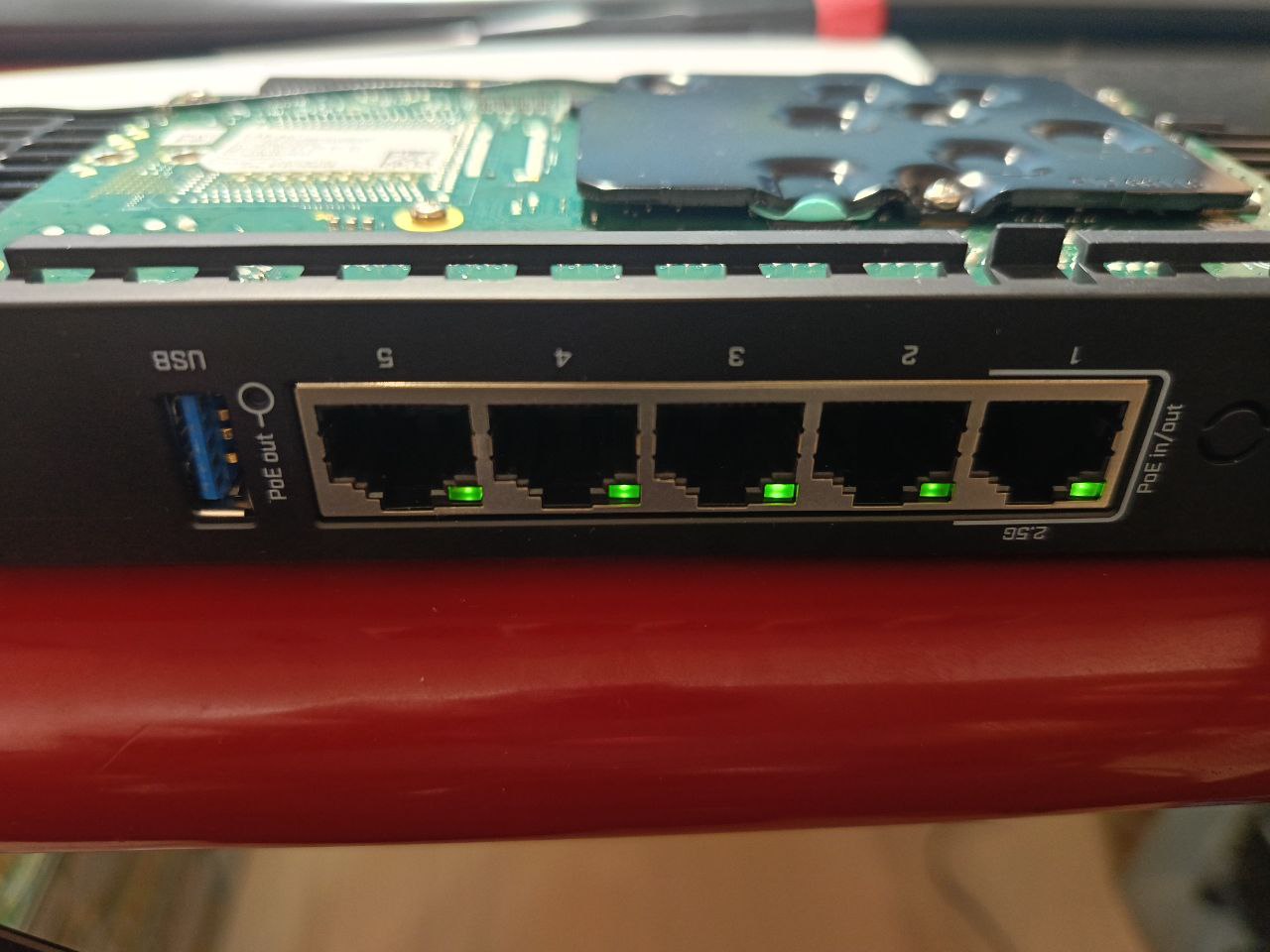

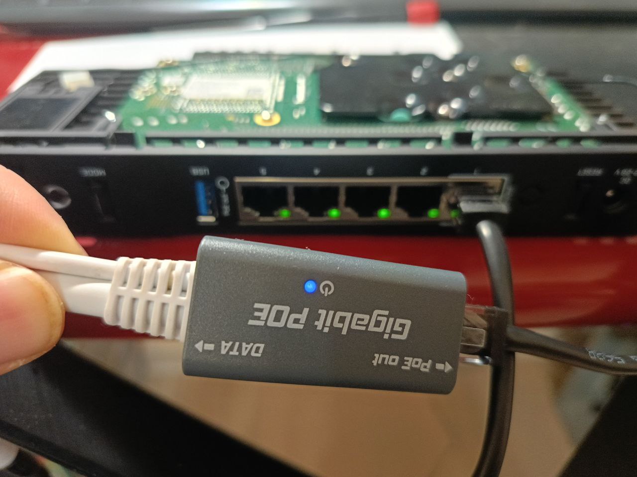

Due wrong connection 28v passive PoE to port5 via original MikroTik RBGPOE Gigabit PoE Injector hAP ax3 burned and now all ports are not works, all leds lights in a half, at front panel 2-3 ports flashing activity without real cable connection.
Board is alive, it can be accessible via wifi. Port tests shows no link at 1,4,5 ports, link-ok at 2-3 ports without real connection.
Power can be delivered via passive PoE to port1 or power-connector.

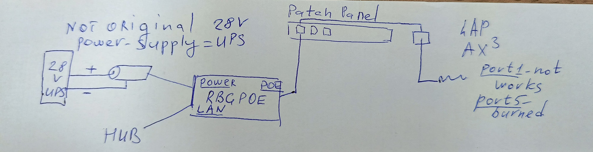

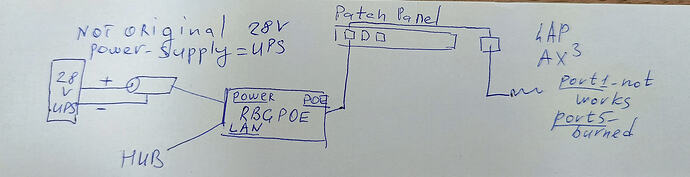

Connected as at picture )

I mean: what did you do wrong to get the “port burned”? Did you mis-wire something (e.g. swapped lead in patch panel, short circuit), did you apply power to ether5 instead of ether1, etc.
Something must have been wrong, they usually do not go defective by themselves and if they do, you can use your warranty.
First sentence.
Ah ok, now I understand. Apparently there is no protection against that.
