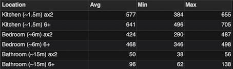

Before switching to 149 I did some very quick tests comparing ax2 wifi to my bridged Eero 6+. Worth noting the Eero likes running 40MHz on 2.4 band and 160 on 5. This is with iperf3 server on NAS, iPerf app on iPhone 12, 2 streams, 30s duration:
Signal on my devices was from memory 5 to 10 dBm better on the Eero, but as you can see speeds are roughly comparable. Note that the double bathroom speeds are probably due to Eero’s 40Mhz width on 2.4. Very impressive for such a tiny device, I would think the overall volume is smaller even than the Eero!
For now however I am disabling wifi and running the Eero again. This bug for TX Power on channels >= 149 kind of defeats the purpose for me, will wait for it to be fixed.
