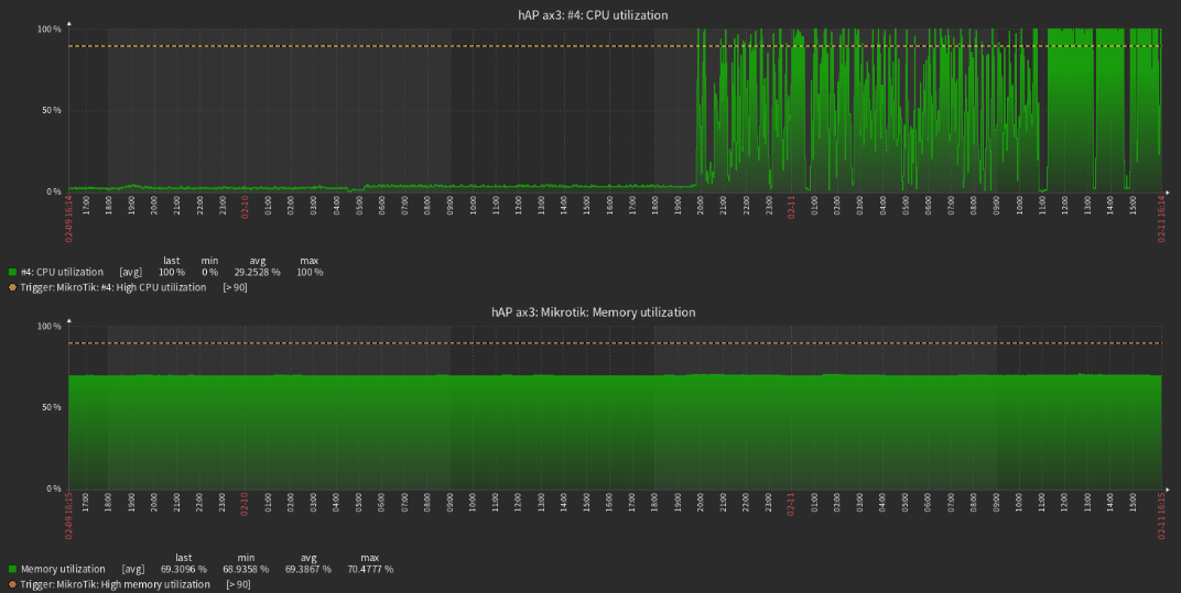

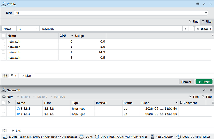

I have an issue with hAP ax3 running RouterOS 7.21.1.
After several days of uptime, CPU usage suddenly becomes very high. The load is mostly caused by the netwatch process.
I only have two netwatch entries configured:
/tool netwatch
add check-certificate=yes disabled=no down-script="" host=1.1.1.1 http-codes=301 name=1.1.1.1 test-script="" timeout=5s type=https-get up-script=""
add check-certificate=yes disabled=no down-script="" host=8.8.8.8 http-codes=302 name=8.8.8.8 test-script="" timeout=5s type=https-get up-script=""
Important observations:
  • Disabling the netwatch entries does NOT help.
  • Removing the netwatch entries completely reduces CPU load after about 10–20 minutes.
  • Rebooting the router immediately fixes the issue.
  • After removing the entries, waiting until CPU normalizes, and then recreating them — everything works fine again for several days, until the problem repeats.
Attached is a CPU graph from the previous occurrence of the issue (you can see long periods of ~90–100% CPU usage).
Has anyone experienced similar behavior with netwatch (https-get + check-certificate=yes) on ROS 7.21.1?
Could this be a memory leak or stuck HTTPS session inside netwatch?
Thank you.
