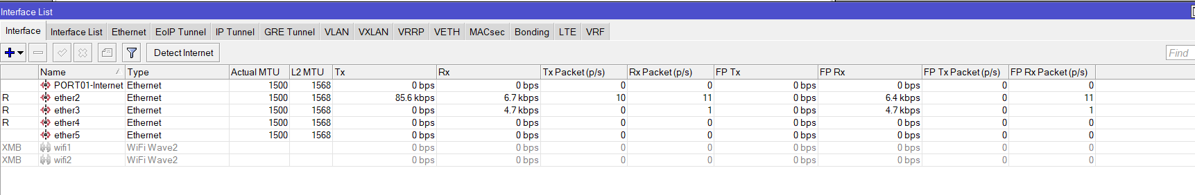

Better yet it doesnt see any traffic (no RX/TX data) see screenshot interfaces.png.
So the same cable is being used, works on Netgear not on MikroTik.
I know that sometimes the modem needs a reboot before handing out the IP to a new device so i restarted the modem and after that i rebooted de MikroTik HAP AX3. (just in case)
On other interfaces it shows traffic e.g: ether2 is my laptop. see screenshot interfaces.png.

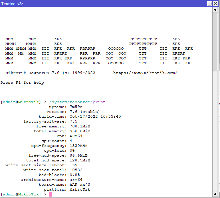

06.) The software version is: 7.6 (stable). see screenshot version.png.

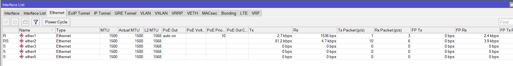

So don’t ask me why but i have RX/TX data on ether1. See “DefaultConfig_ether1_DataYes.png”
What i did:
01.) run /system reset-configuration no-defaults=no skip-backup=yes
02.) So the default config came back.
03.) Connected the same Yellow WAN cable to port01/ether1, in port02/ether2 i connected my laptop with the same WHITE cable.
So i have RX/TX data but no internet yet.

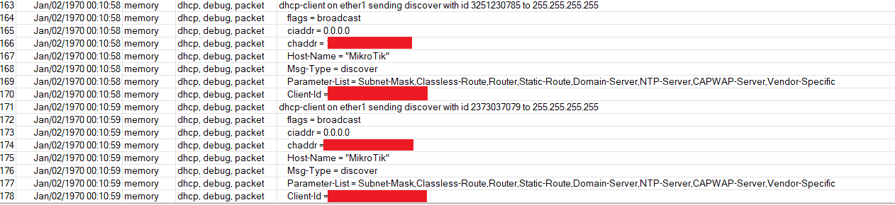

No luck yet, after some reading i found out you can add the DHCP logs to the LOG.
I added it there are some messages but i dont know what it says. (see screenshot dhcp.png)
Also everytime i'm trying to configure a DHCP client on ether1 or ether2 the status keeps saying "searching".
I think this is the problem but i did not find a solution.
