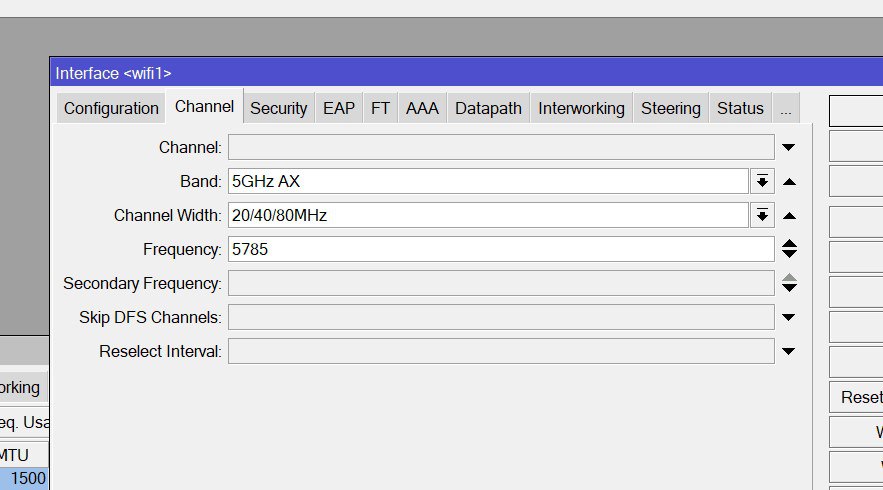

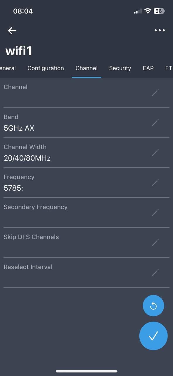

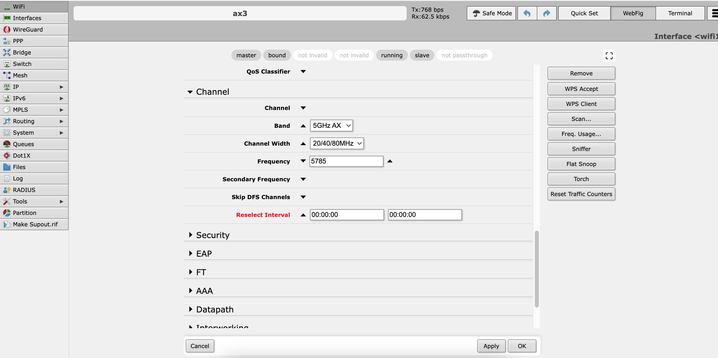

I would also like to point out that the programs (winbox, webfig, mobile application for iOS) for configuration have a different interface for the “Reselect Interval” parameter, which also complicates the configuration of the router and can even create random errors in the configuration.
Hi, same behavior about reselect interval

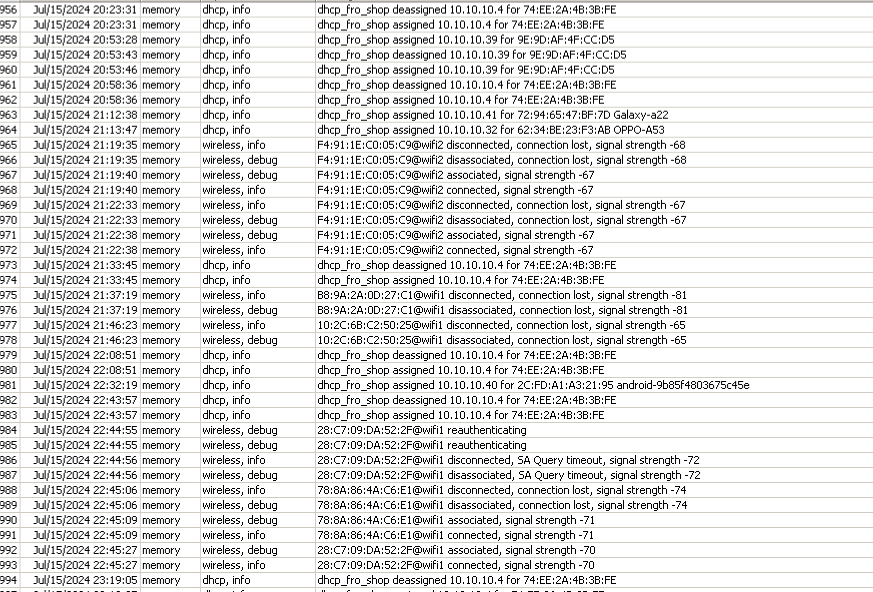

Can you enable logging on your device 9D:08? maybe you see a reason there why it disconnects.
How I can enable logging for a device?
Although “Can you do xxxx?” is frequently used as a polite form of “Do xxxx!”, the same wording may surprisingly mean an actual question :slight_smile: Some devices support logging and some don’t, and since the MAC address of your device in question is private, it is not possible to find out the vendor, so it is not possible for anyone but you to know whether it is a computer, a mobile phone, or an IoT device, and hence whether logging is supported.
Other than that, is only that single MAC address affected in your case?

Depends on the device. If it is a PC or alike it may be easier to access log files than on an iphone (still possible IIRC). But to avoid confusion: I mean logging on the affected device itself. You see a regular disconnect in your AP logs. But you don’t know why the client disconnected. That information is not available - except on the client itself.
This was one of suggestions of MikroTik support guy. I can tell that this didn’t solve disconnect problem neither on 7.15 nor on 7.15.1 on hap ax3 device (haven’t tried 7.15.2 yet, but since there are no changes to wifi-qcom driver, I don’t see a reason to give it a shot). I did try a bunch of configurations starting from the one after reset button, ending with a bunch of tweaks and sending around 10-15 supout files - no luck. It now became inconvenient for me to reboot the router here and there to upgrade to 7.15 and rollback again to working firmware after another tweak didn’t do the trick, so I gave up on this and now use 7.14.1 until some information on disconnects show up. The only consistent thing I’ve noticed is that the more load on the network was done, the more chances to disconnect occur. So the connection could be “stable” for hours if I just leave device working, and could drop each 15 minutes while e.g. watching YouTube.
