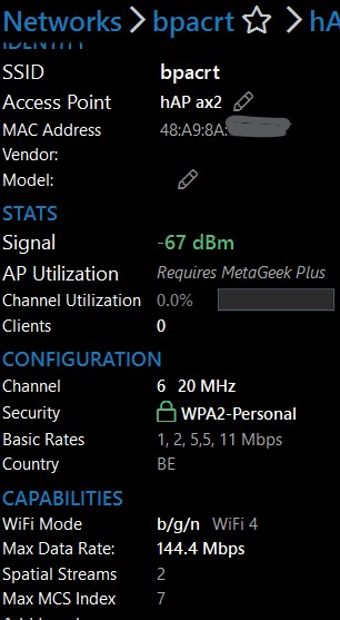

With hAP ax2, the ROS setting is not clear, and it is not in the list with " /interface/wifi/radio> print terse"

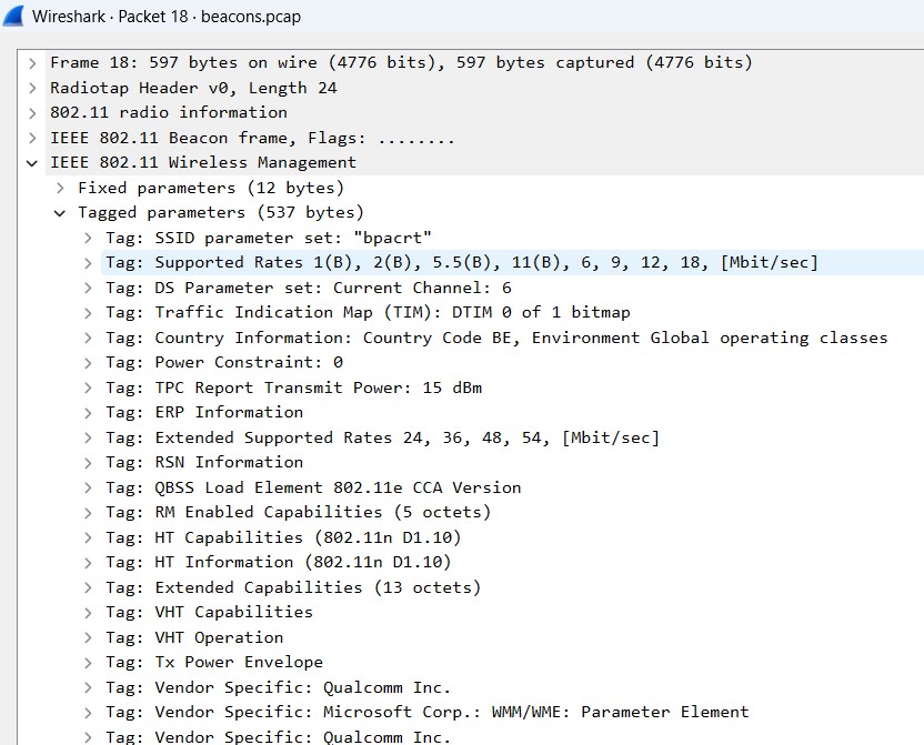

but the beacon clearly announces also the B channel, with band set to N
Even the basic rates is mainly the B channel.
(INSSIDer collects all beacons (cfr ‘export summary’ under File menu, viewed here with wireshark.)

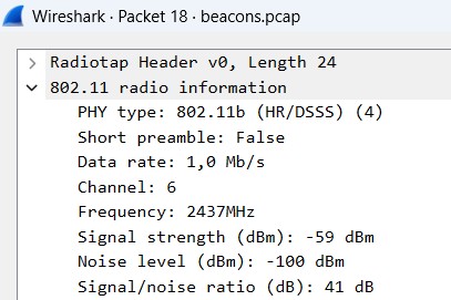

The B is actually there!. The captured beacon was sent at 1Mbps (a B interface rate) with DSSS encoding , and the content of the beacon says " that AP supports B"
PHY type: 802.11b (HR/DSSS) (4)
