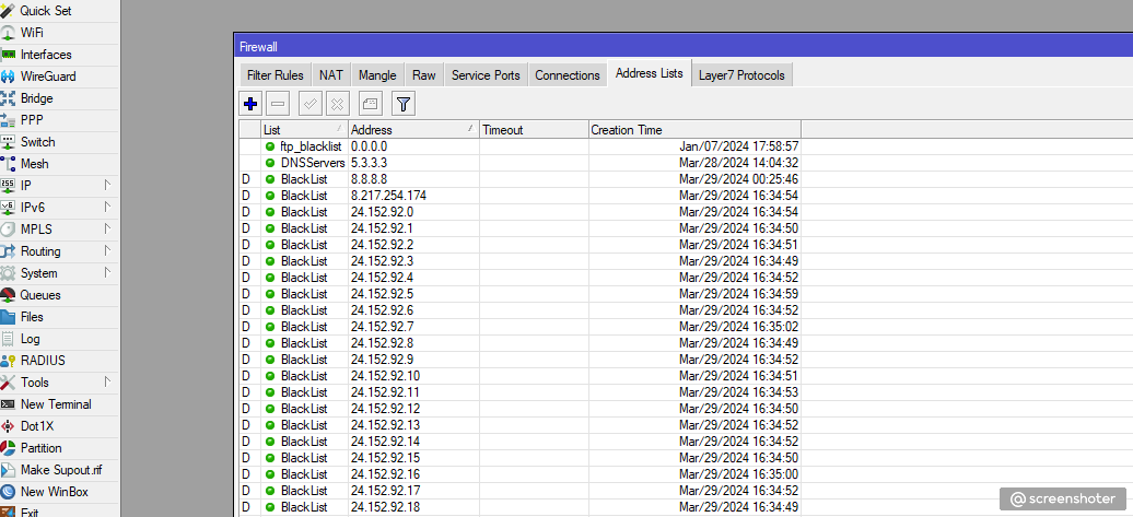

How big does that dynamic address list get after 1 day, 2 days, 3 days ?
If it only keeps growing, you can hit a memory limit …
In 6 hours after the reboot, the memory decreased by 400MB.
Are we talking about /firewall address lists? if so, how do I limit its size?
How to limit the address list ?
Don’t use it … simple, no ?
The way I see it (provided unlimited memory space), you are going to end up with every address on the internet if you never clean up that address list.
Why do you want to list those trying to get in ?
Simply drop them in raw rule (MUCH faster) and done.
What’s the use of listing those IPs ?
What else are you going to do with it ?
Besides, processing that list on itself also takes away resources from your device.
Like memory … but also CPU.
Turn it around.
ONLY allow what should be allowed. DROP ALL ELSE.
(hmmm … sounds like a solid firewall concept too :laughing: )
