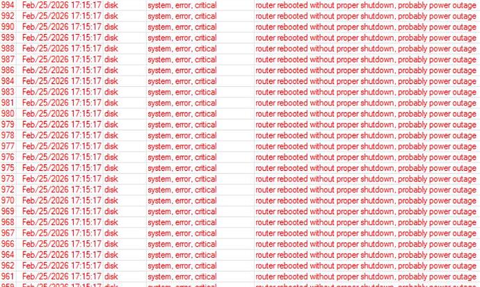

hAP AX3 to many logs rebooted without proper shutdown

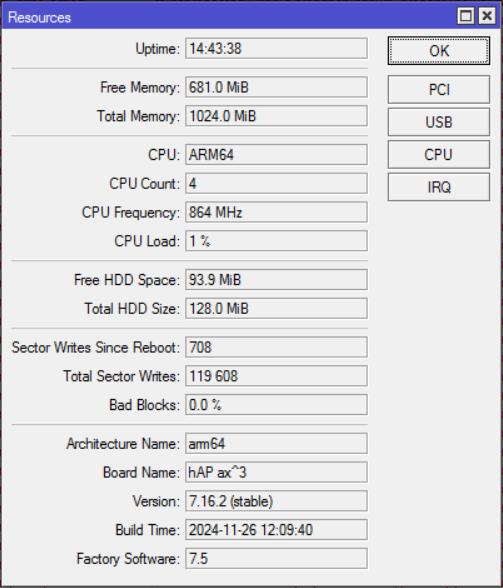

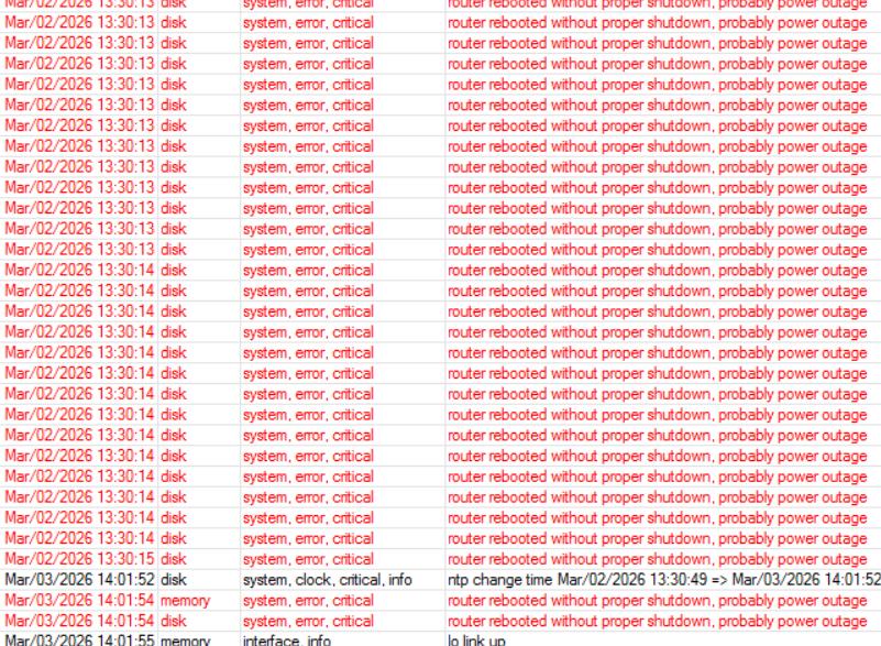

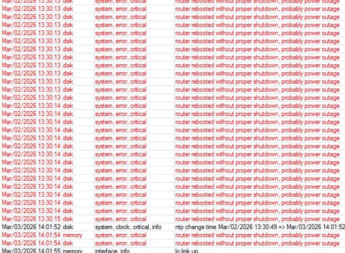

Recently the router sometimes reboots itself. The log has many entries with the same time.
I changed the power supply, monitoring in zabbix does not indicate CPU high load or temperature, and there is no high traffic.
What are your tips?
The logs are suspicious: they all bear the same time stamp (precise up to single second ... and device needs much more than one second to boot up), so I'd say it was a single event (but logged many times).
Other than that: I suggest you to upgrade ROS on your device. There's a long-term ROSv7 now available (7.20.x IIRC) ... or stay at 7.19.8 (which seems to be version of choice for quite a few forum members as a very stable version). Don't forget to upgrade also routerboot (System -> Routerboard).

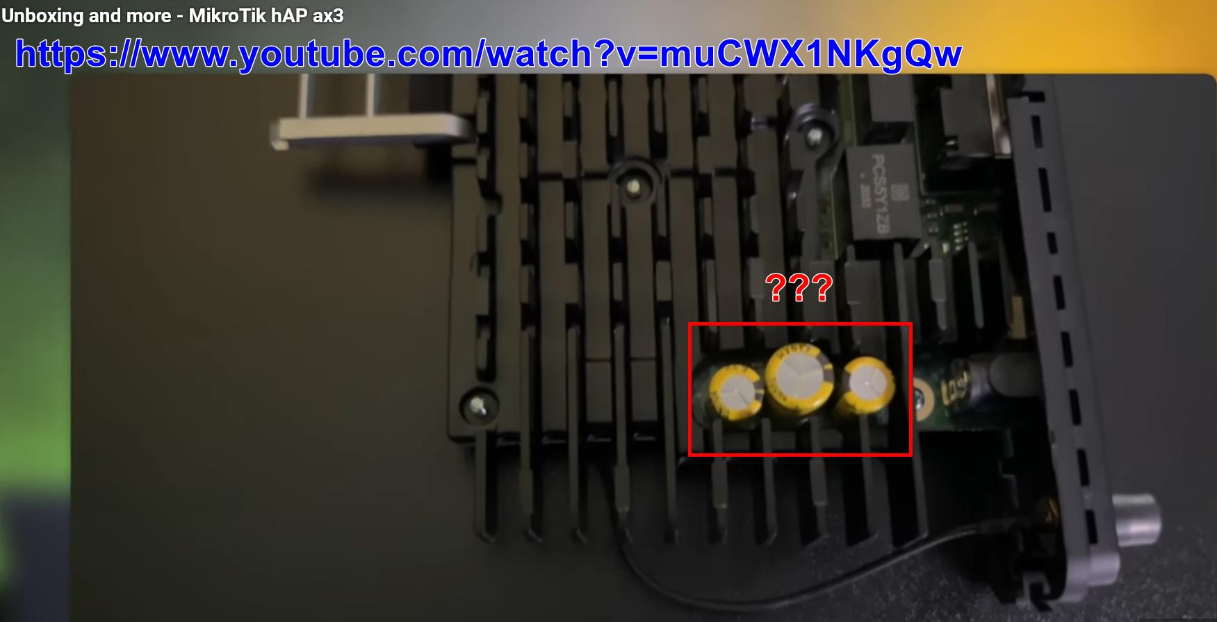

Thank you, but maybe this is a hardware problem with the capacitors inside the router itself?
See screenshot with https://www.youtube.com/watch?v=muCWX1NKgQw

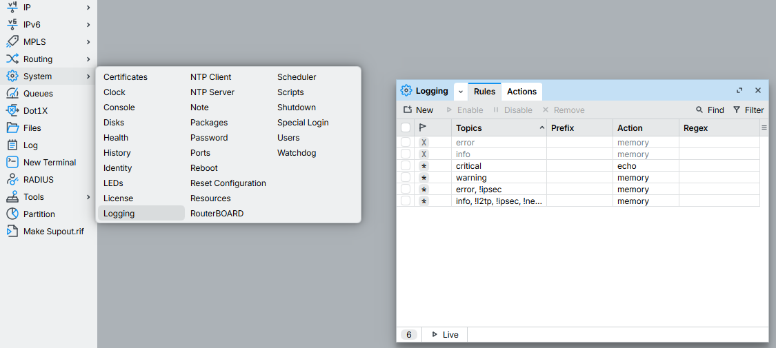

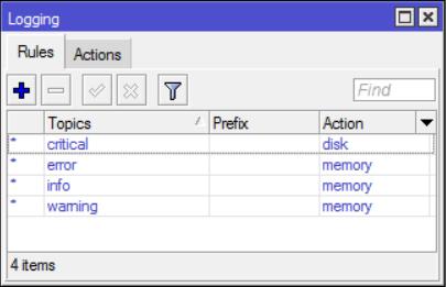

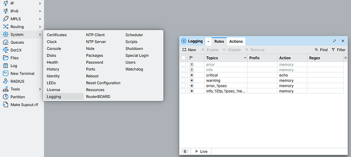

Please post screenshot or export of System -> Logging -> Rules .
There's always possibility of hardware defect ... and yes, failing capacitors are often causing intermittent problems (which are getting more frequent as the state of capacitors degrades).
But there's a track record of bugs in software (and every software has it, so nothing special for MT in here) which get fixed with time. Hence suggestion to upgrade ROS to a known stable version (I mentioned 7.19.x which is a tad older than current long-term, but according to my own experience and experience of many forum users it is a very stable version ... meaning that if your problems continue even after installing the said ROS version, it means that problem is likely a hardware one).

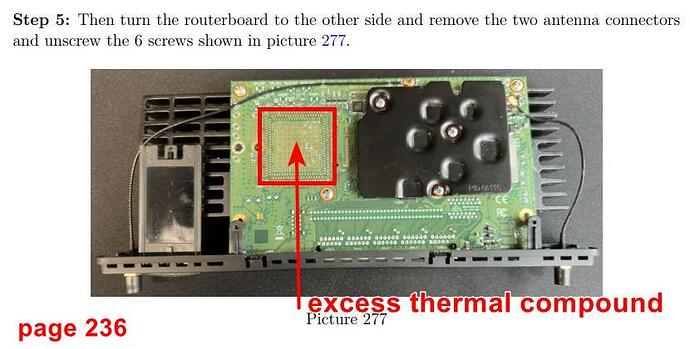

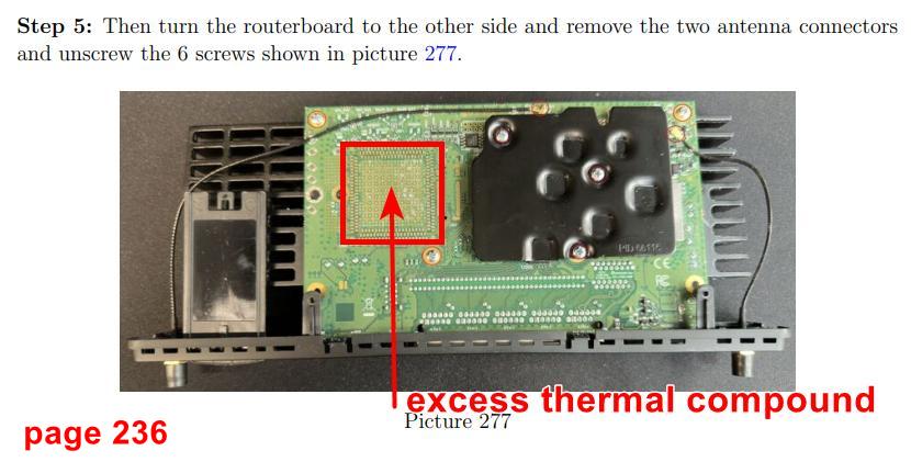

I found an interesting file on the Internet with instructions for disassembling and testing Mikotik routers:
https://download.discomp.cz/MikroTik/Overvoltage/overvoltage_instructions_2024-02-29.pdf
There was excess thermal paste on the back side PCB of my router, which I removed (see screenshot from file).

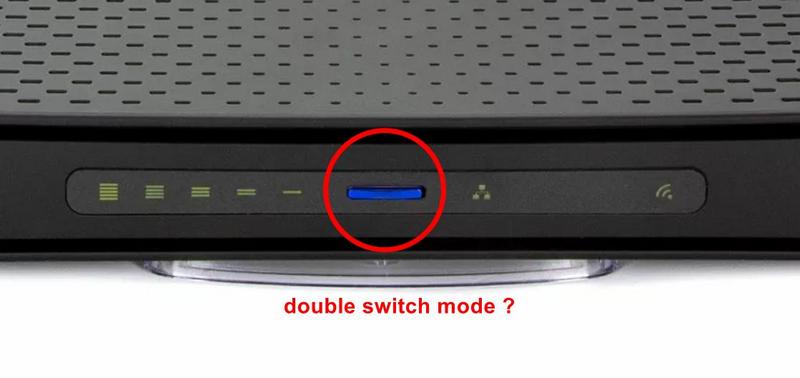

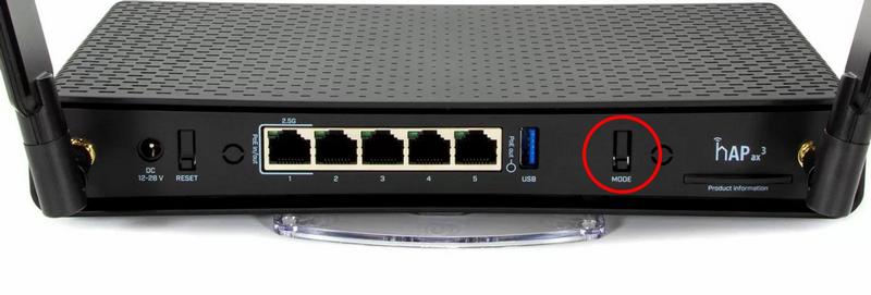

off top - By the way, what's that switch on the front panel?
Does it duplicate the rear switch?

It's the WPS button:
The D53, C53, S53 and H53 series RouterBoards have configurable WPS button. It also works in the same way as reset button and mode button and executes a script

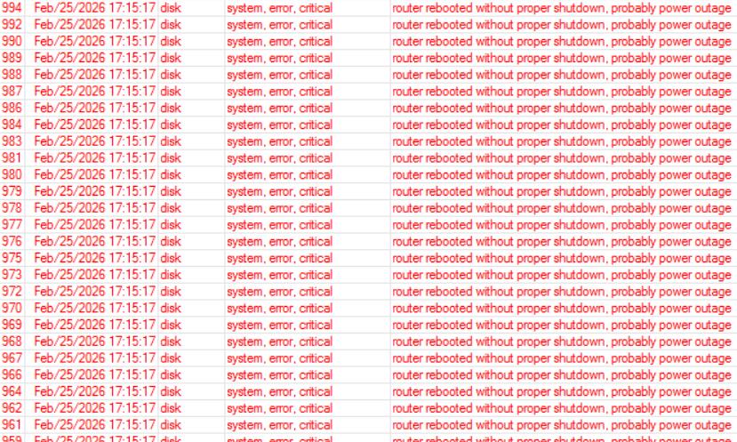

After emergency shutdown AC power i see many messages in the log again when router turn it on (
