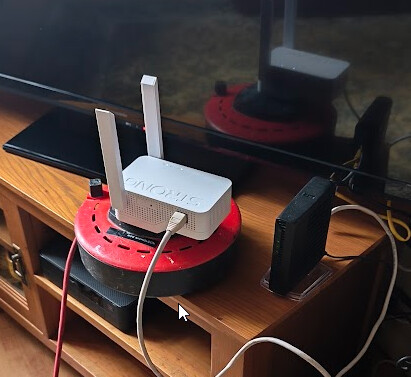

Okay had 30 minutes spare to do a test. Now, I know this is not a scientific test in a totally controlled environment but I've put the two devices side by side:
Ookla speed test in clear line of sight about 3m away and both devices give 260Mbps - the maximum of my internet connection. I then walked into the garden which is about 15m away still with reasonable line of sight and just a glass patio door in the way. My crude mobile signal display starts to show the clear difference:
Speed test on the STRONG stayed at 260Mbps but hAP ax2 dropped to 136Mbps. Both of these devices are MIMO 2x2 with transmit power set to maximum. The STRONG does have external antennae which has been discussed to death. I don't have an AX3 to do the same test with as it should be even more comparable as it's also got external antennae.

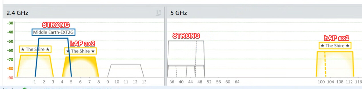

Well, you can get - for what it costs - Wifi Analyzer and have easier to compare readings.
Please be aware that there is more than one tool called Wifi Analyzer, I mean this one:
https://play.google.com/store/apps/details?id=com.vrem.wifianalyzer
Yes, already got that installed on my mobile and use it a lot when installing client Wi-Fi. But for the purposes of this top-level discussion, the mobile Wi-Fi strength is enough to show a clear difference. I have since discovered the STRONG has 160MHz channel width. I put it to 80MHz but no discernible difference. I don't think my mobile can do 160MHz anyway.

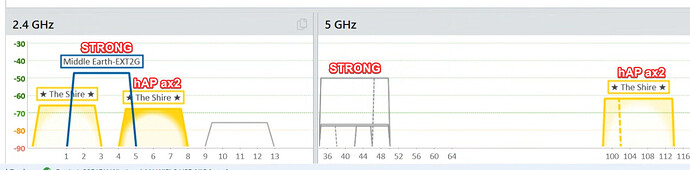

More observations. My Wi-Fi 6 laptop at about 8m from the devices. The difference in 2.4GHz signal strength is clear. 5GHz -50dBM on STRONG, -63dBm on hAP ax2. We all know that a -13dbm makes a huge difference.

Because you not even use the same frequency. It is like attaching ax2 to different WAN and ISP and different bandwidth plans and then saying: meh, poor speed. and also orientation of a device with built-in antennas can make a difference as well.
Can you swap used channels on AX2 and STRONG ?
You're not playing in the same field ...

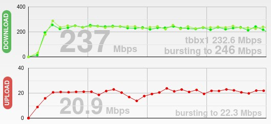

Infact on my cruddy old phone i get 230/240Mbps everywhere ie full speed of my internet. Could I find a dead spot if i tried real hard, maybe my gym yep hu hu huh 60Mbps outside in another world.
