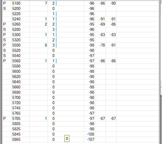

Could you please give me the range that I should set?
Well, depends on your RF environment.
Use
/interface/wifi/scan
and
/interface/wifi/spectral-scan
to see frequency utilization. Do one for each radio. Reading the results you can set an appropriate frequency or multiple.
Otherwise just use frequency=auto together with rescan-interval (e.g. “12h-24h”) as a good start.

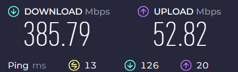

I did it. Now it’s much better, signal plus stability but never reach full speed. I have 1Gbps/50Mbps and only in front of the router I got this result:
That’s about right for a 40 MHz channel I get 300 on mine. You can try to set it to 20/40/80 MHz and see how it works. 80 MHz will be faster but is more subject to interference and performance issues in noisy environments. So, for me, I’m fine taking a performance hit at the gain of better quality wifi. If I really need high bandwidth to move big files, I’ll use a computer connected to a switch.
The real benefit of 80 MHz, IMO, is range with decent speed.
If you just look at MCS index real quick, you will see that, say, with 0.8us guard interval, you get 117 Mbps at an MCS index of 3 for 80 MHz, but you only get 121.5 Mbps at an MCS index of 6 for 40 MHz. It’s just how radio science works: double the frequency range, double the bandwidth.
This means that, in terms of raw speed of the network, you can maintain a decent speed in a larger radius with 80 MHz than with 40 MHz.
