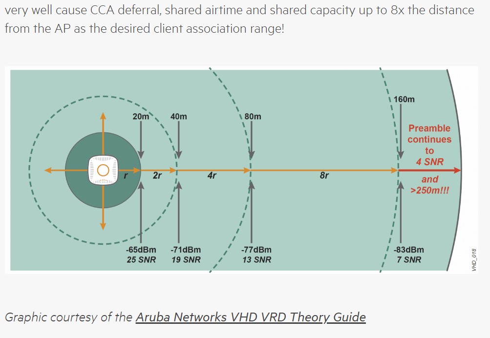

Difficult one, not an answer but just thoughts…
For the indoor case:
Sending:
EIRP limits the sum of TXpower and gain to the same sum value.
The antenna gain does not gain any TX emitted energy. What is gained in one direction, is lost in another.
So high antenna gain leads to lower TXpower overall. (because of EIRP limit)
Indoors it all bounces around , and you have to pass walls and ceiliings etc. So I would guess that low gain high TXpower is better here
Receiving:
No power sum limit, antenna gain makes RX receiver more sensitive
So I would guess that high gain, because TXpower irrelevant, is better here, if not too much neighbor transmitters.
(interference goes much further than usable/decodable signal)
Outdoor is a different case ! Avoid interference.
https://blogs.arubanetworks.com/industries/push-it-to-the-limit-understand-wi-fis-breaking-point-to-design-better-wlans/
