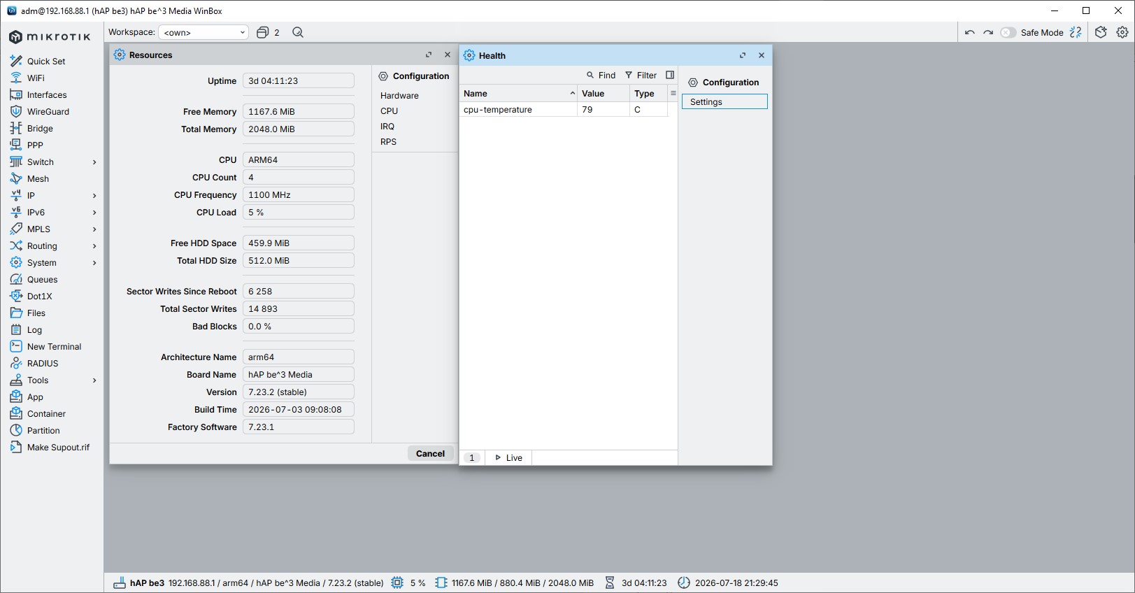

Hap be3 Media CPU temperature
Idle -73°
If Cpu Load 3-6% CPU temperature 79-80°. Router box hot.
It`s good?
What was the ambient temperature at the time of these temps?
Approximately 25°C. Normal room temperature. Router surface hot.

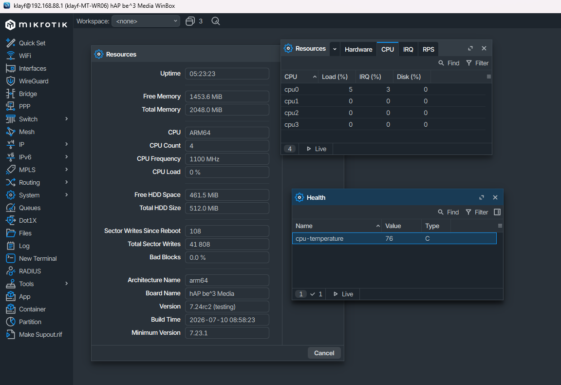

I used it for about 3 days with 7.24rc2 installed, and it reports CPU temp of 70–78C when the ambient temp remains between 26–30C.

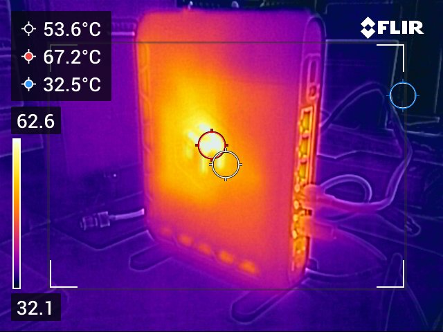

At this time, the thermal camera showed a surface temperature of 53C on the side with the Mikrotik logo, 67C on the heatsink, and approximately 64C on the opposite side (without the logo hole).
The be3's CPU temp is definitely higher than that of the ax3 (-63C), which has a faster CPU clock, and I suspect this is because many devices such as the QCN6274, Bluetooth, and USB 3.0 hub have been added.
I am currently using a USB fan installed, and the cpu temperature remains between 50–60C.
*Update: I rebooted my router 5 hours ago, and with an ambient temperature of 28-29C, the CPU temp reached 75-76C in idle state. (No USB fan, powered via PoE)
In this state, the power consumption reported by the PoE switch is 14W. (3 RJ-45 ports in use, no Wi-Fi devices)
